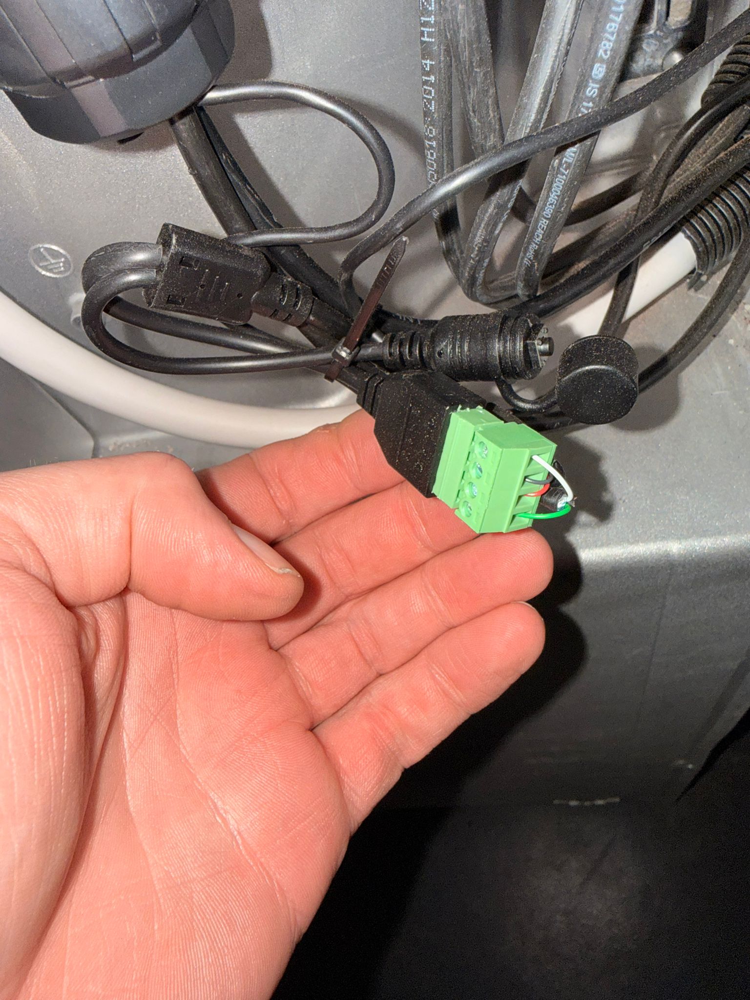

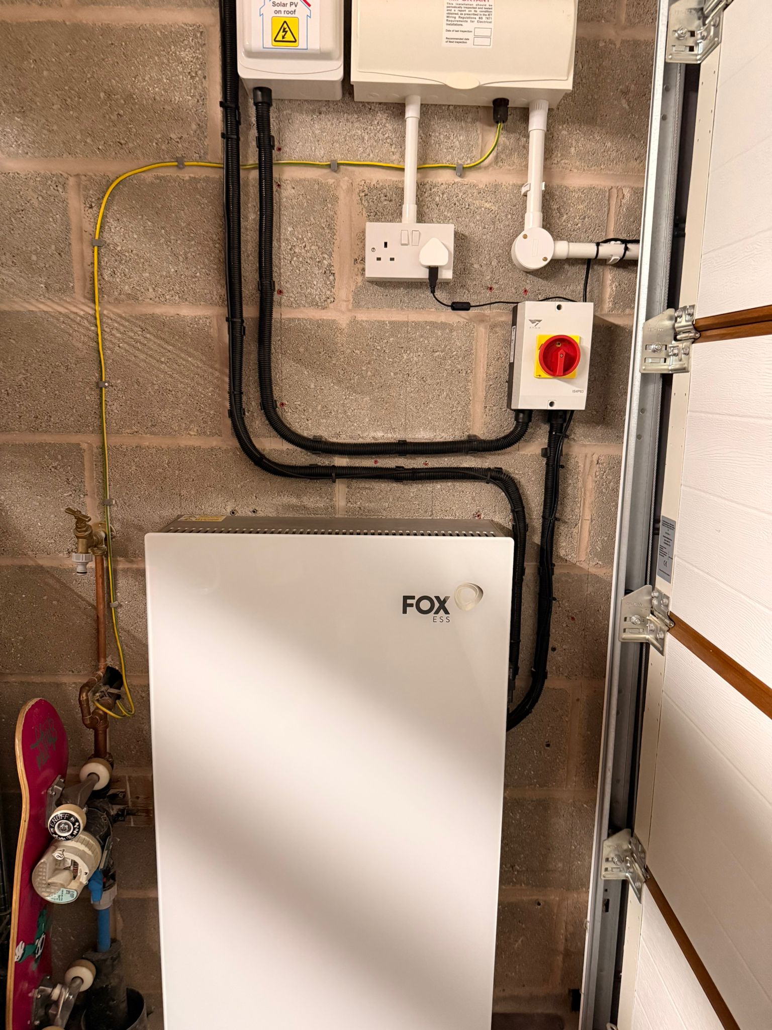

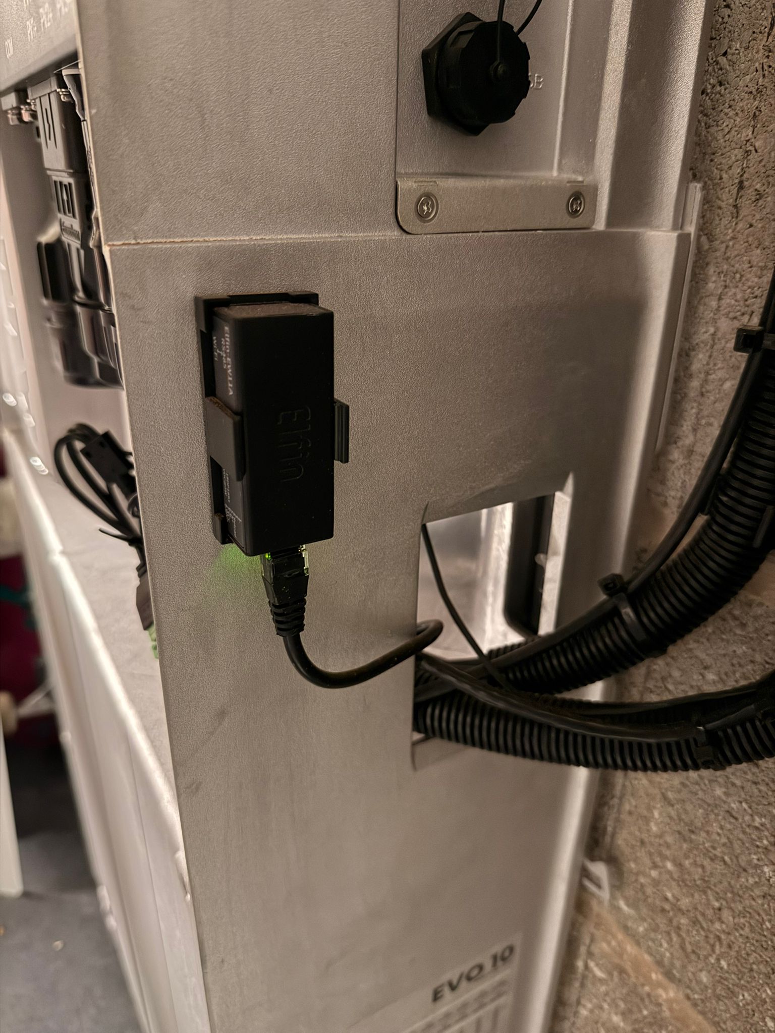

Hi Paul,
see the attached.
i followed the wiring instructions exactly per the github page for the modbus integration.
I used an old usb cable to make the power and rs485 connections. to see how to wire the the rs485 to the data port on the inverter you have the pin diagram in the booklet that comes with the evo. if neded, I can take a photo of inside the connector on the weekend and share it.
to fix the EW11 to the outside of the inverter I used some velcro tape and its given power with the USB power adapter you see in the overview photo.
Best
Adam
