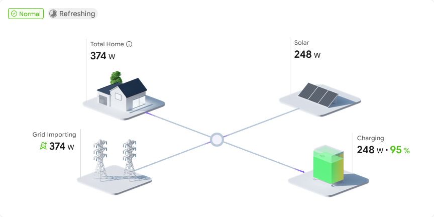

This is not a fix for me. Once the FDSoC is reached (95% in this case), Solar switched to charging the battery, but the Home was supported by Grid Import, so no improvement, See the image:
