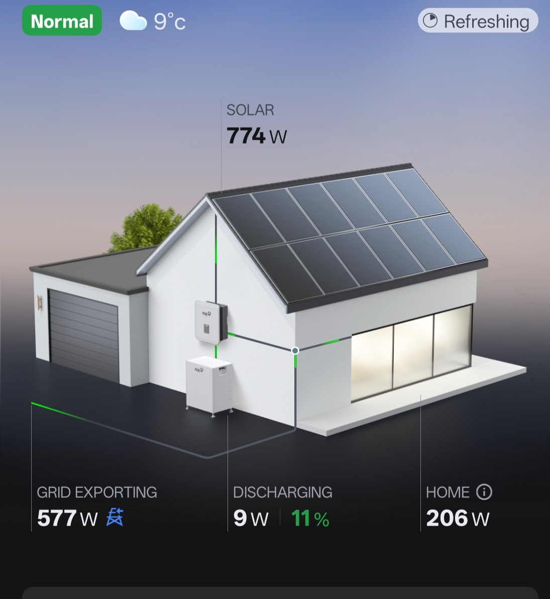

Previously when setting force charge to say 30%, battery would charge to 30% from grid, but battery would continue to charge beyond 30% from any excess solar (Self use)
The % you set in Force-charge now seems to be setting max-SoC, rather than a FCSOC so any surplus solar is now exported (Feed-in priority)
I'm struggling to fathom under what circumstances that behaviour is desirable. Is this another bug in the update?
Its similar to the other weird behaviour with force discharge acting as a min-SOC rather than a FDSOC.

In attached image FCSoC is 11%
