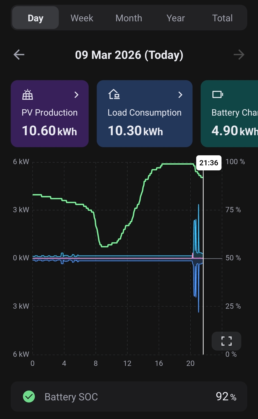

It has not, the system app is not reporting PV production or home consumption. This was from a few days ago.
Seems odd that its not reporting elements of the system

Thank you for the support a hard reset worked.
The system was working (noted by today's PV production) but not reported.
System is about 4 weeks old. I hope this won't be a regular thing
