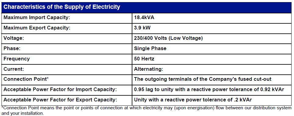

Serious question, does Australia have a permission notification on how much Import/Export you can have on your lines?
UK we have to have permission and calculations done to tell us our hard limits.
My G99 certificate for example
