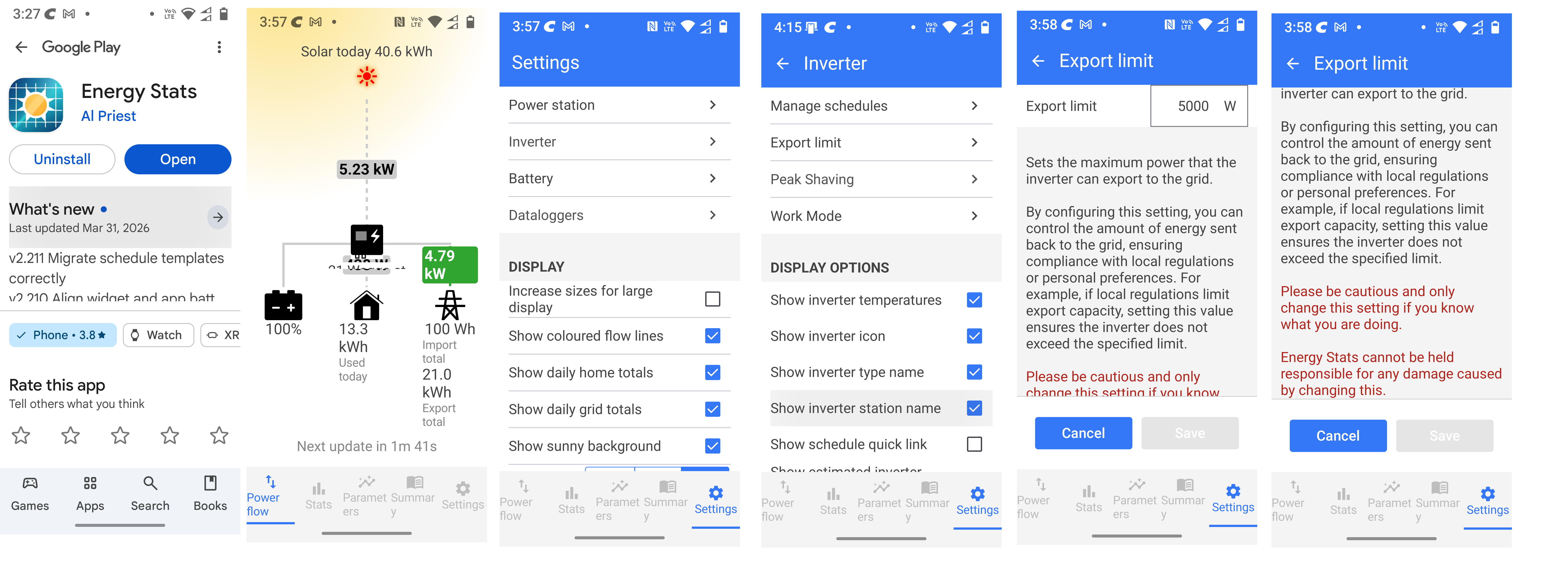

I couldn’t let this go.
No i’m not really into “all the VPP stuff going on in Australia” as I’m concerned that these VPP’s including Amber seem to be run by a bunch of cowboys, and let’s not forget that quite a lot of the issues raised on this site seem to have been caused by VPP’s…. and suggesting that simply changing a legitimate value be taken out of our hands and given to someone like Amber is just not on for me….. I’m not reliant or interested in joining a VPP or alike as I don’t need any more headaches in my life at present.
Now back to my original topic:
For those interested the “Export Limit” value can be changed thru the “Energy Stats” app as follows:
Open the “Energy Stats” app, goto Settings, Inverter, Export Limit, and there it is.
NOTE: Read the cautionary note and then if you are accepting responsibility then go for it.
Change the value in the panel at top right of screen, press save and it’s that simple. This change will also be reflected in the FoxCloud app ‘Quick Settings’ almost immediately.
This is how it's done thru Energy Stats.
