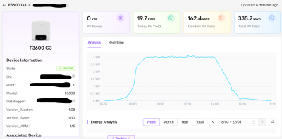

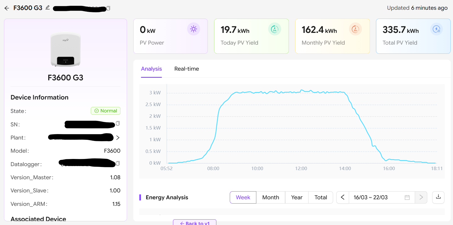

F3600 G3 inverter clipping @3kw!
HI
Had my system installed at beginning of Feb
13 x 640Longi panels on two buildings, one with 6 panels on, one with 7.
2 inverters, 1 x 3kw (F3000 G2) for the 6 panel set up 1 x 3.6kw for 7 panel system. (F3600 G3)
these then feed back to house via mains then into inverter and battery.
the system is all set up for G99 as per DNO.
The 3kw system has been working fine and has produced up to 3.2kw
the 3.6kw is not working as it should and have spoken to Fox UK without much luck.
please see a plot from today to give an idea. but basically its clipping at 3kw.
there have been days when it will surge past the 3kw and has even stayed there for 20 - 30 mins, but then will drop well bellow.
All 7 panels are on one string, but both the installer and Fox UK have said this was fine and would help maximise low light power!!
anyone have any idea why this could be behaving like this?
I can add screen shots from the days when it has reached the 3.82kw that the data sheet says but its never for long!

Re: F3600 G3 inverter clipping @3kw!
It does look like the firmware is old, not saying an upgrade will fix the issue, but you never know?
Both inverters would need updating fully, Master/Manager/Slave.

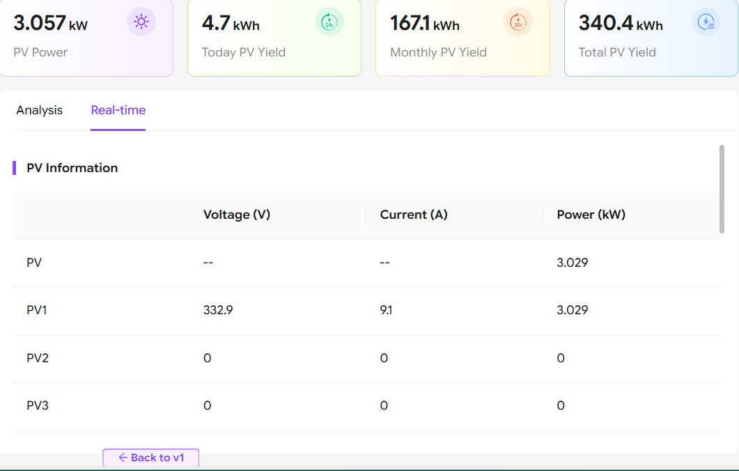

Inverter temps have not been problem, its in a cartlodge, so in the outside but shaded.
PV is showing 332.9v but only 9,1amp
they are rated to 14,4-18.6 amps so not sure if its the inverter holding them down

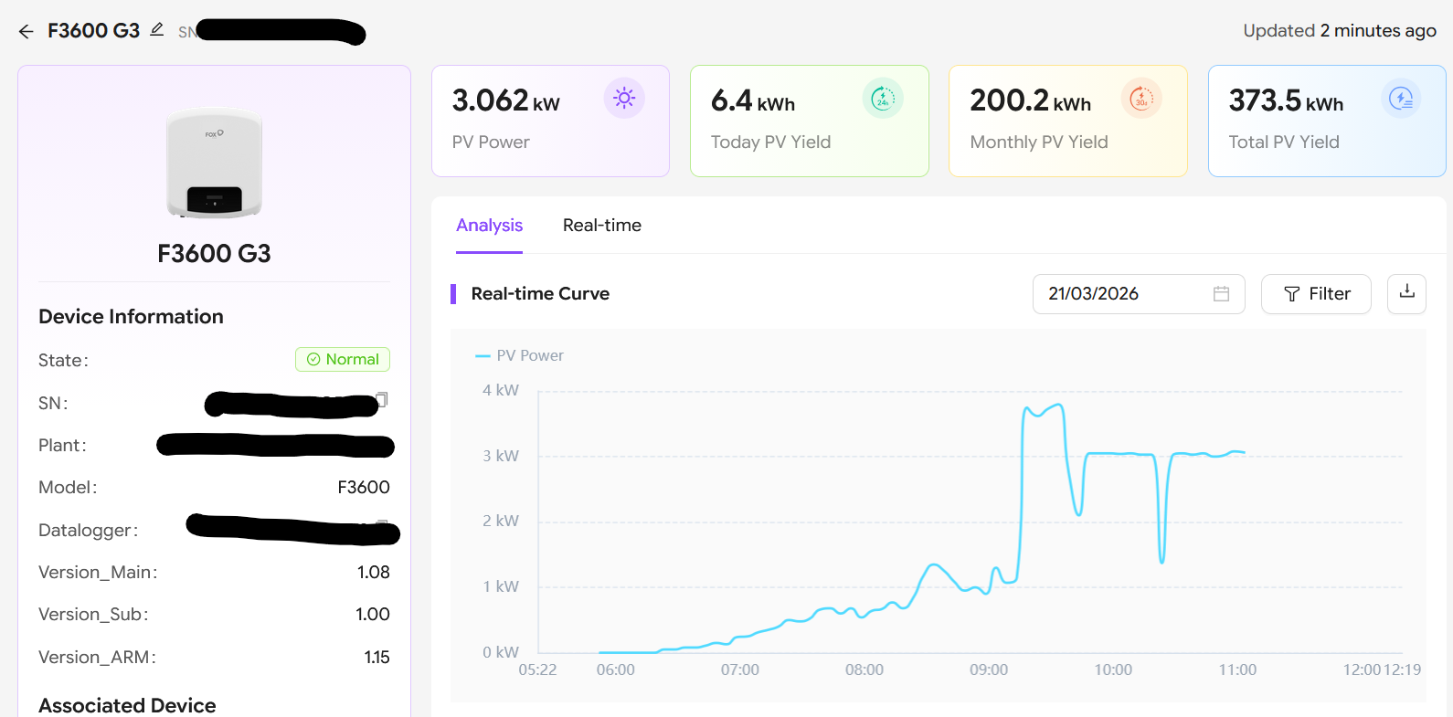

Well another day and another 1kw + per hour lost!!
Have emailed Fox UK and spoken to installer, Installer thinks it may well be inverter.
FOX ESS Uk completely disinterested and say there is nothing wrong!! very disappointed in the level of customer service.
the plot shows the inverter/panels can make way more than 3kw, but always default back. its like there is some component that unless it gets a sudden surge is limiting the current.
Have ordered a second hand 5kw inverter from ebay (not fox) and will see what the panels do then.

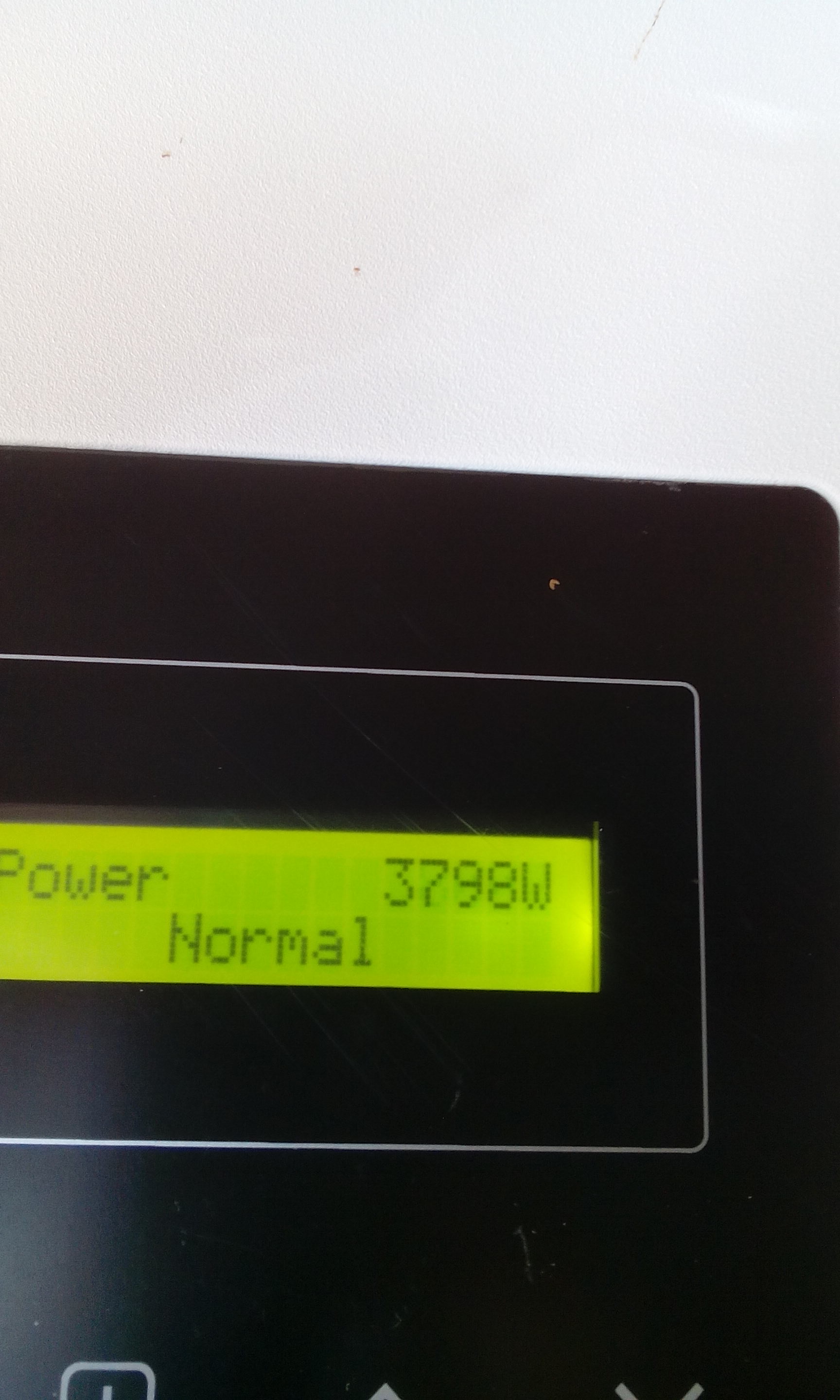

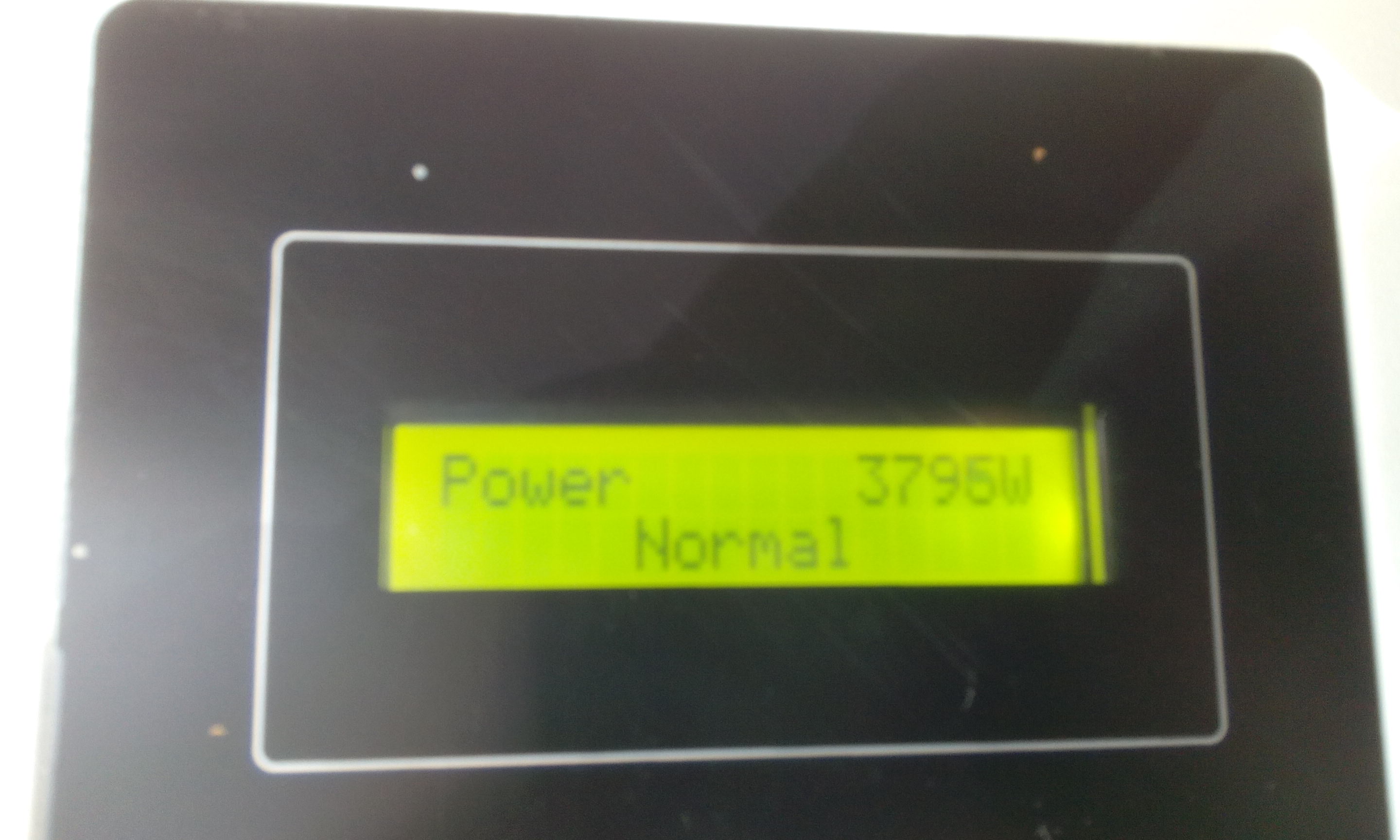

Have now had a Solex inverter fitted to the string that the F3600 G3 was fitted to, and it has been able to maintain up to 3800w with peeks of 4040w
So its quite clear that the Fox F3600 is at fault, but getting Fox UK to accept is going to be the next challenge.
Its quite odd that a second hand Solex that is 6 years old is working better than a bran new Fox unit, under identical conditions.
images from sunny periods at 10am this morning.

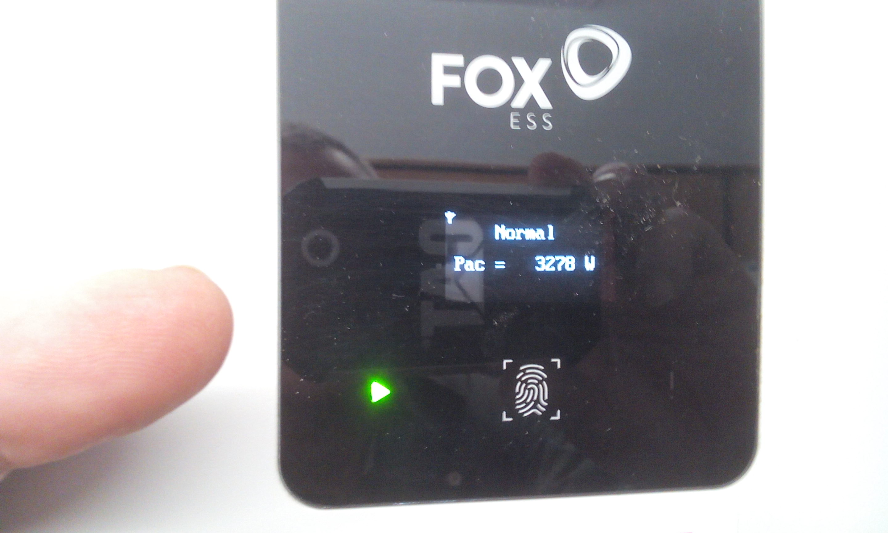

Another update.
So while the Solex inverter has proved the Cart lodge string can produce in-excess of 4kw.

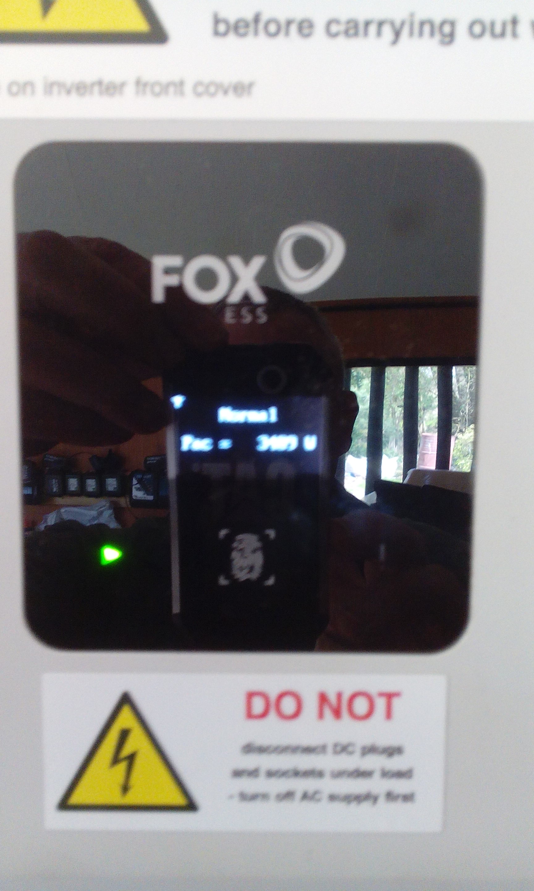

Have moved the F3600 G3 to the workshop string where the 6 x 640w panels are split into 2 strings 3 in each.
Had read on other forums from Australia that many people have seen the inverters cap/clip @3kw on a single string. even 5.7kw units.
So this is a picture from the Workshop with the F3600, it had no problem with producing 3.2-3.4kw consistently, which would confirm my original thoughts that 3kw is the max per string. sorry second pic is blurry but phone wouldn't focus on bright display.
