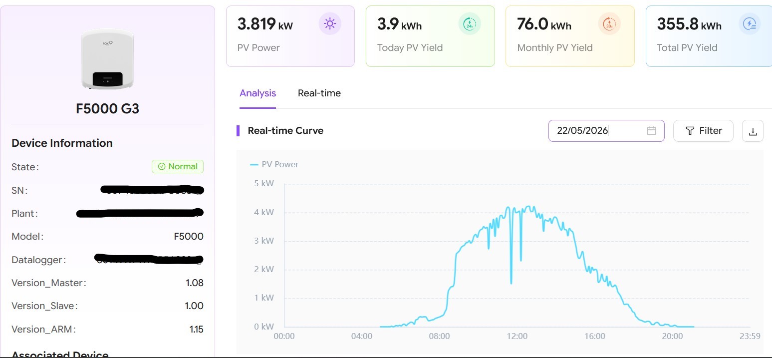

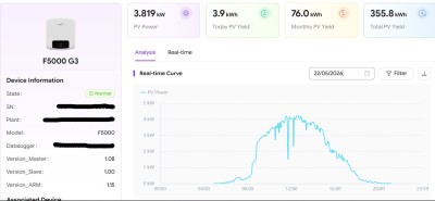

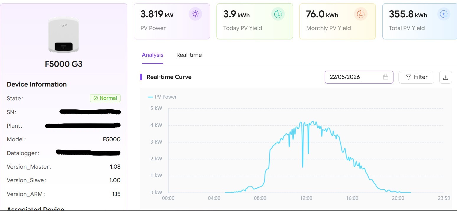

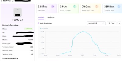

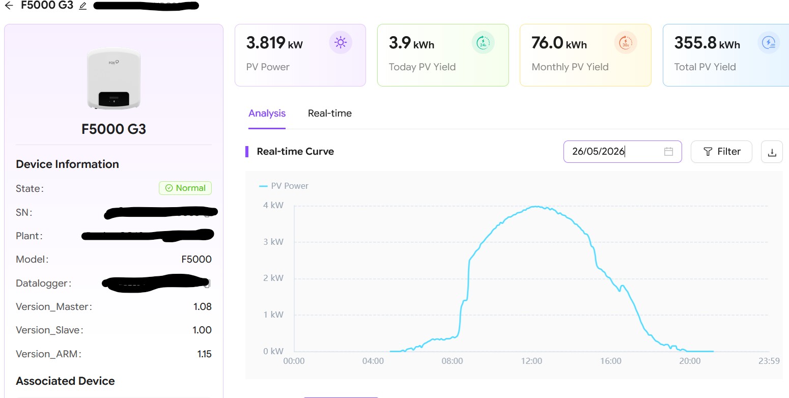

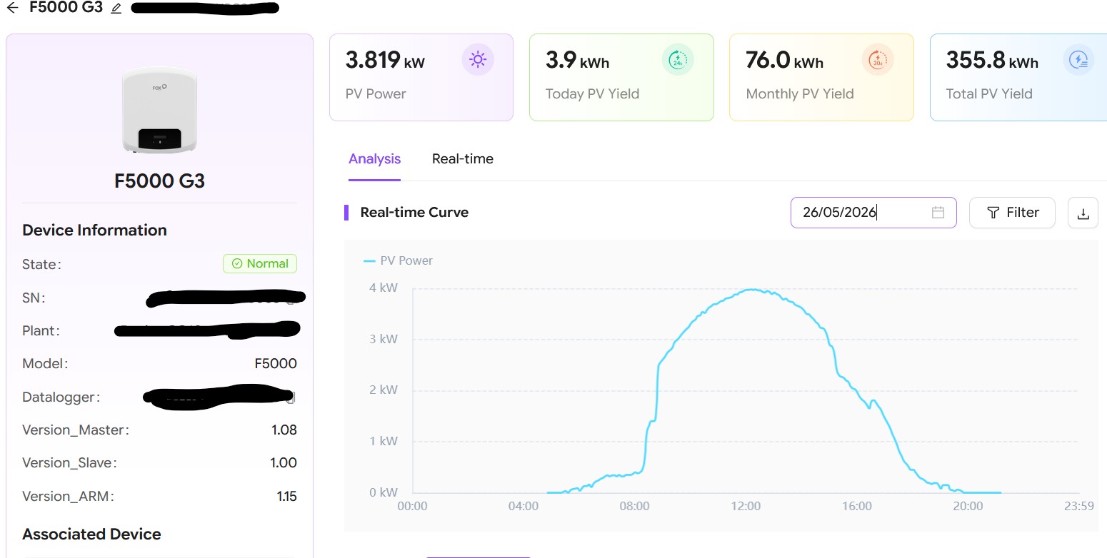

A little update.
Had an F5000 fitted and kept as single string for few days, then had string split into 3 x 640w & 4 x 640w
both times the system was able to generate over 4kwh output.
So sadly Fox's insistence that the F3600 was not clipping is so very wrong, it clearly was.
First pick is single string, second is 2 strings
