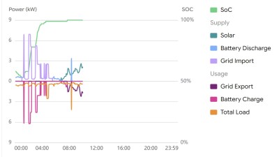

I am trying the Capture AI program to control my battery......
is there a web interface to view it or only the mobile app?
I understand that once the battery is charged overnight at 7p/kWh (I have Octopus smart EV tariff) it will be used during the day to power the home if the PV output isnt enough to cover the load but when would the battery be topped up again?.......I dont want to end up with no battery capacity in the evening
FOX KH7 7kw hybrid inverter
EN-EPS-BOX-SP gateway
Re: Capture AI settings
edit...
It appears to take the battery offline when the cheap rate starts, running the house load on cheap rate leccy, then later reconnects the battery and charges it...I guess that makes more sense than running the battery right down before recharging it
during the day the battery remains full with the PV providing house load and exporting any surplus.....
all seems very clever...lets hope its not too clever :D
