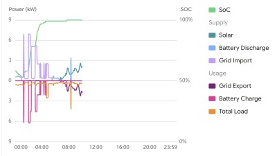

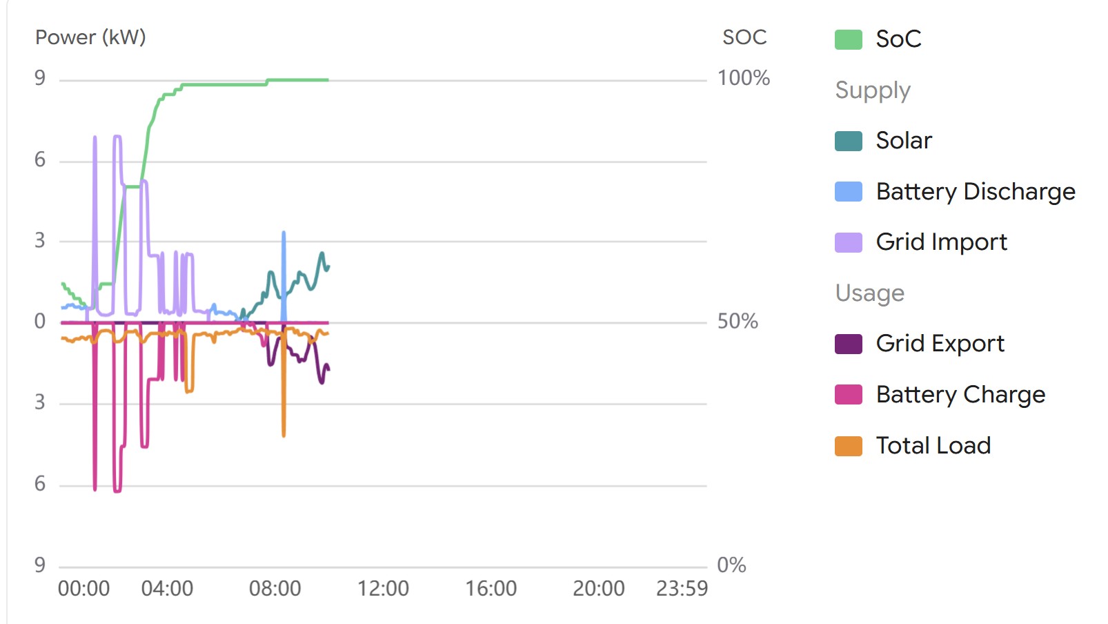

It appears to take the battery offline when the cheap rate starts, running the house load on cheap rate leccy, then later reconnects the battery and charges it...I guess that makes more sense than running the battery right down before recharging it
during the day the battery remains full with the PV providing house load and exporting any surplus.....
all seems very clever...lets hope its not too clever

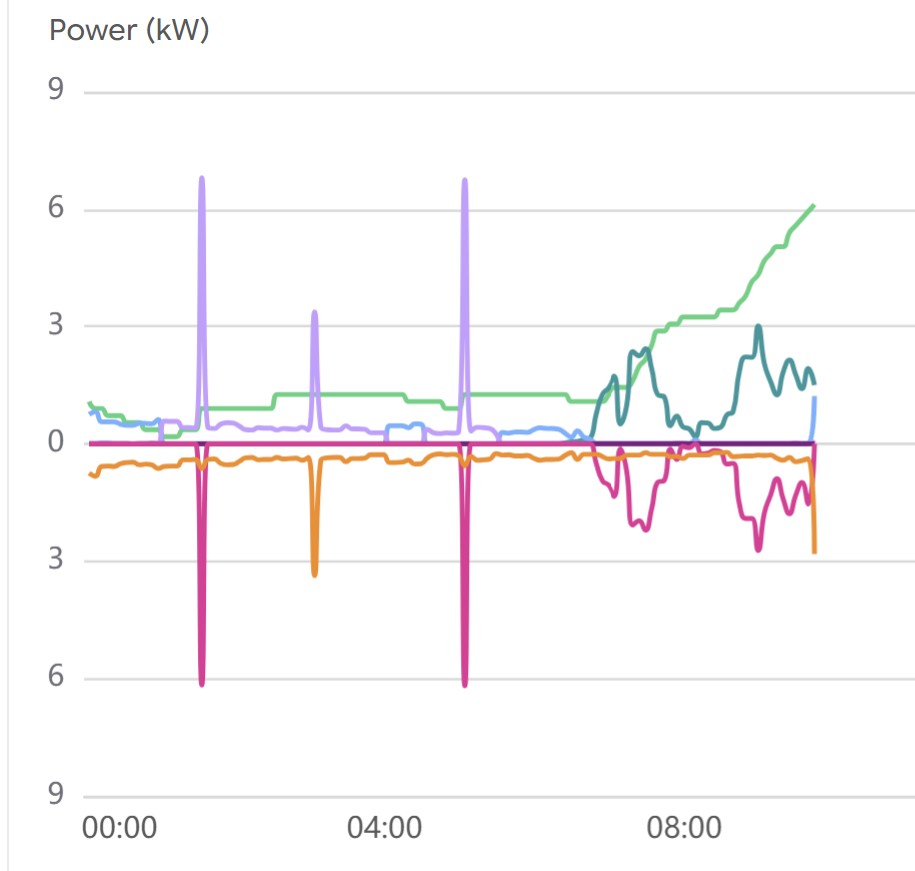

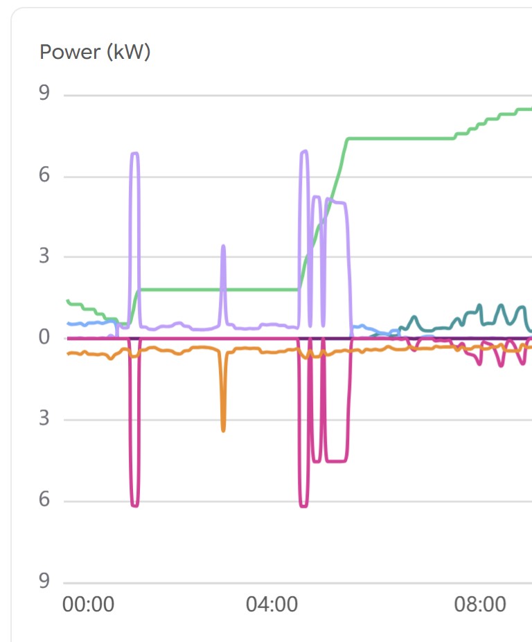

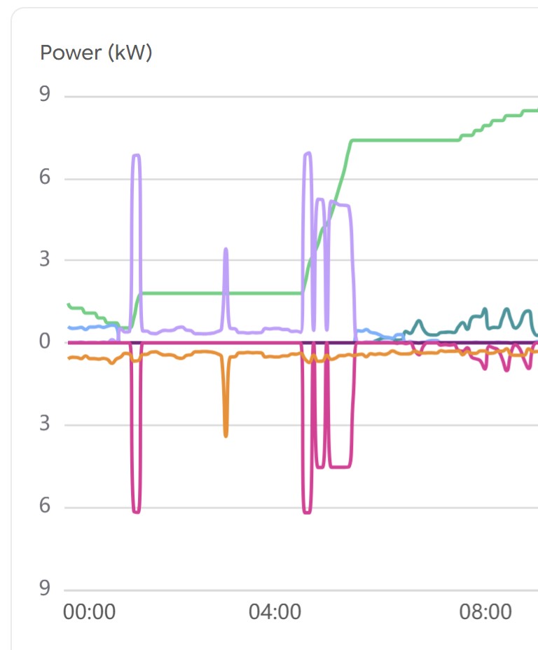

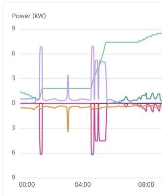

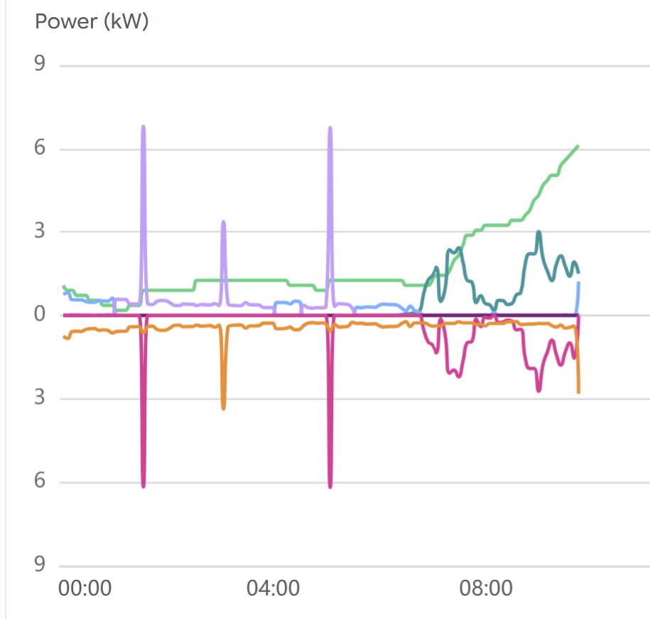

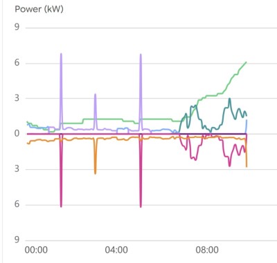

Not 100% convinced about this....it has been taking the battery offline in the early hours, presumably to stop it discharging and then boost charges it before my cheap rate ends at 05:30......but NOT every day, this morning for instance I awoke at 7am to find the battery at only 57%.....and it is now charging from the PV which, surely should be exporting
The usage graph shows two attempted charges but they only lasted about 5 minutes......surely it should fully charge the battery on the cheap rate overnight tariff ???
previous days have been similar to this chart.....
