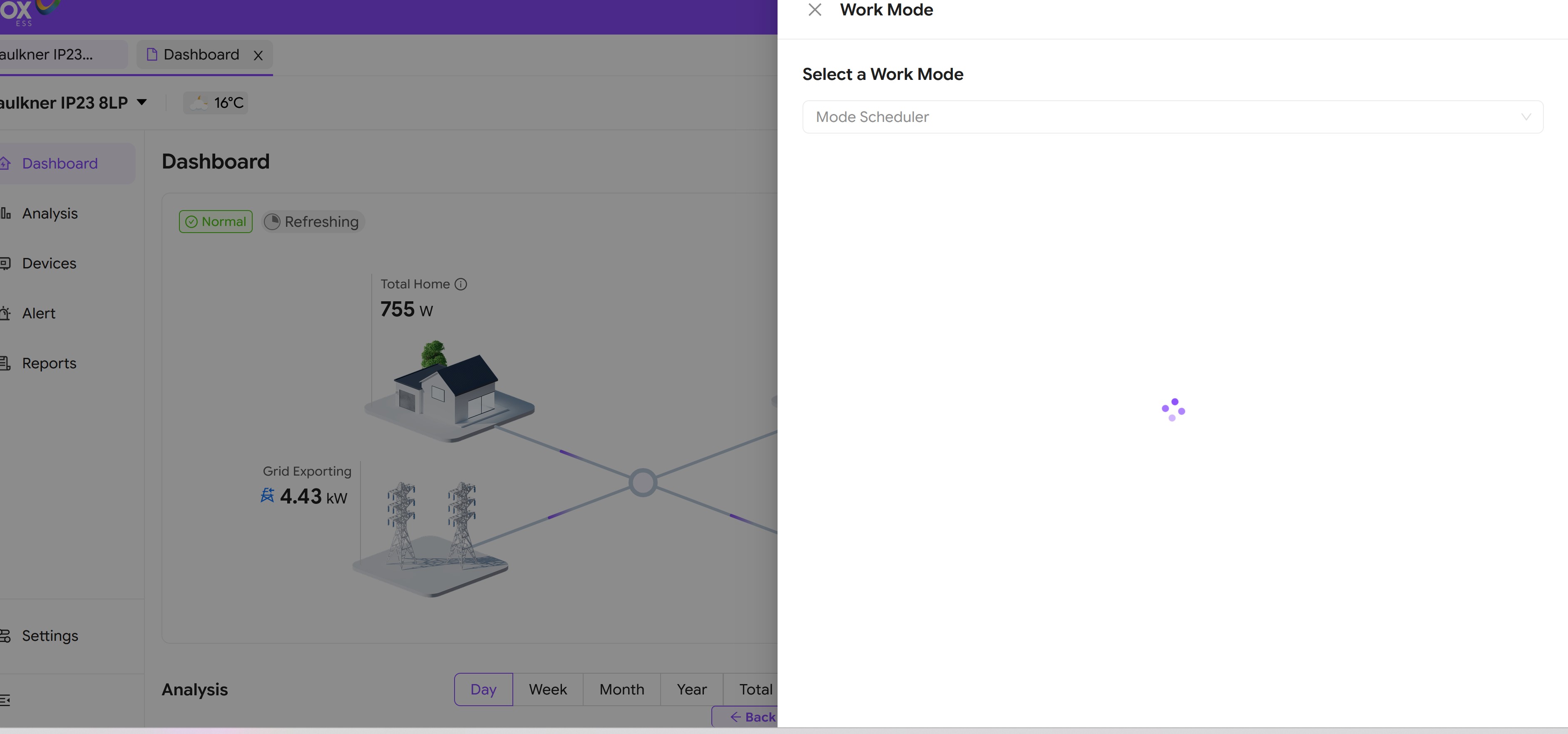

As of the last few days I cannott open the scheduler from a Win 11 PC....the roundel just spins and spins, have tried 3 browsers and 2 laptop/PC's
FOX KH7 7kw hybrid inverter
EN-EPS-BOX-SP gateway
Re: Mode Scheduler from a browser
davidwf15 wrote: Thu Aug 20, 2026 12:22 am As of the last few days I cannott open the scheduler from a Win 11 PC....the roundel just spins and spins, have tried 3 browsers and 2 laptop/PC's
If it doesn’t work in the app as well it could be a data connection issue, when you click the scheduler button it fetches in real time the schedule from the inverter which will need a good internet connection - probably worth starting with the easiest things and restart your router, if it still isn’t working next step would be a shutdown restart of the inverter.
