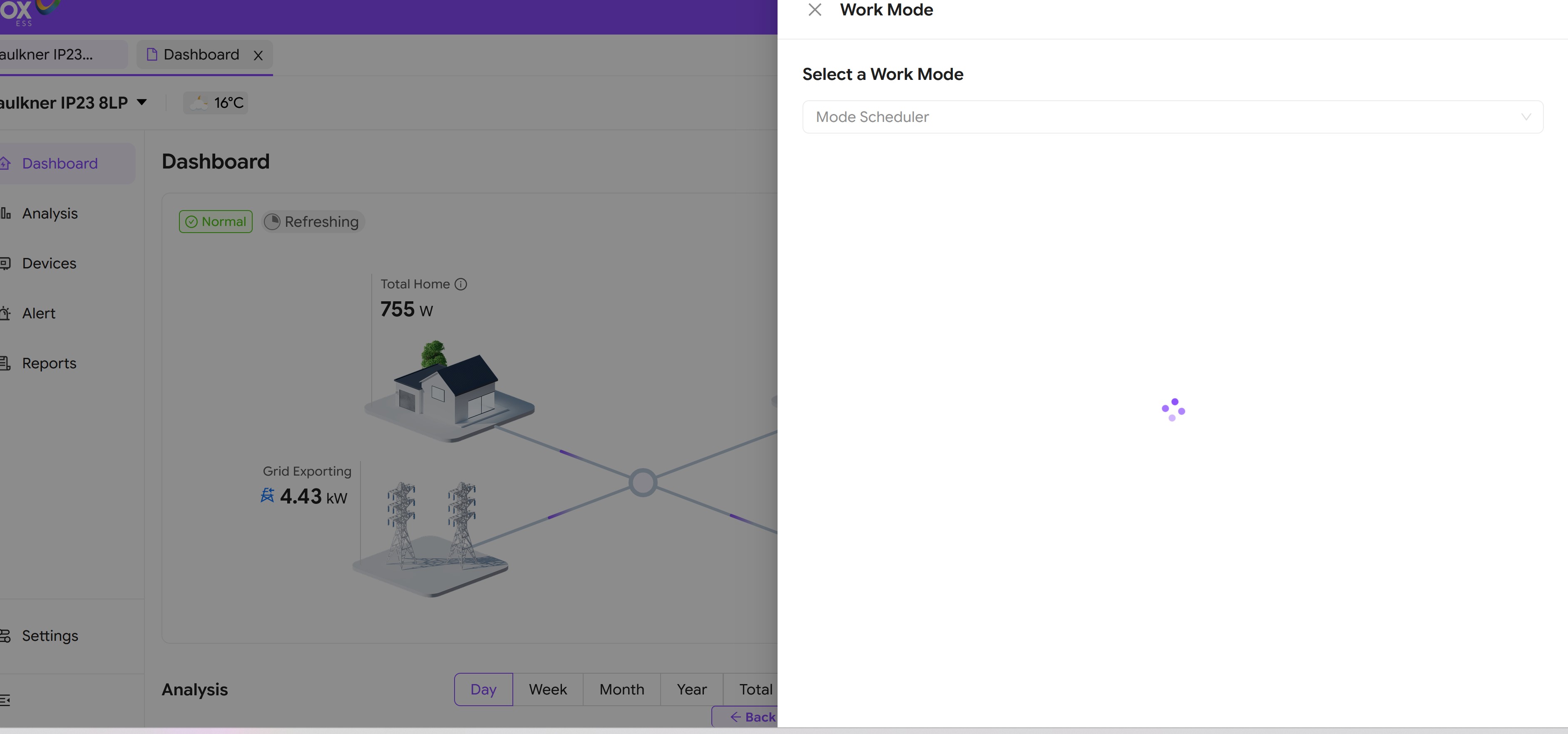

I cannot find the Mode Scheduler from the dashboard in a browser (Firefox and Chrome). I have looked under quick settings and work mode only shows the 4 basic modes. The User Guide shows it being accessed via the Devices section but it is not visible to me:

On the right hand side of the dashboard, click on work mode ‘Details’, then drop down the box, it’s under mode scheduler
As of the last few days I cannott open the scheduler from a Win 11 PC....the roundel just spins and spins, have tried 3 browsers and 2 laptop/PC's

If it doesn’t work in the app as well it could be a data connection issue, when you click the scheduler button it fetches in real time the schedule from the inverter which will need a good internet connection - probably worth starting with the easiest things and restart your router, if it still isn’t working next step would be a shutdown restart of the inverter.
nope, the app is immediate

I have figured out the issue.
https://www.foxesscloud.com/v2 redirects to a non https login route, and then to a non https dashboard. This dashboard is where the work mode popout fails, because it tries to access Crypto.randomUUID() which does not exist.
https://www.foxesscloud.com/v2/ and https://www.foxesscloud.com/v2/login both stay on https.
Aside from this bug in the routing, I am not sure why a non https login is even provided. There should never be a case where login details are sent over the web unencrypted, and it is very concerning that a company of this size would allow that to happen. It is coincidental that when creating a shortcut to the login page, I did so with the first link.
I have contacted Fox support directly so they can hopefully resolve this.
