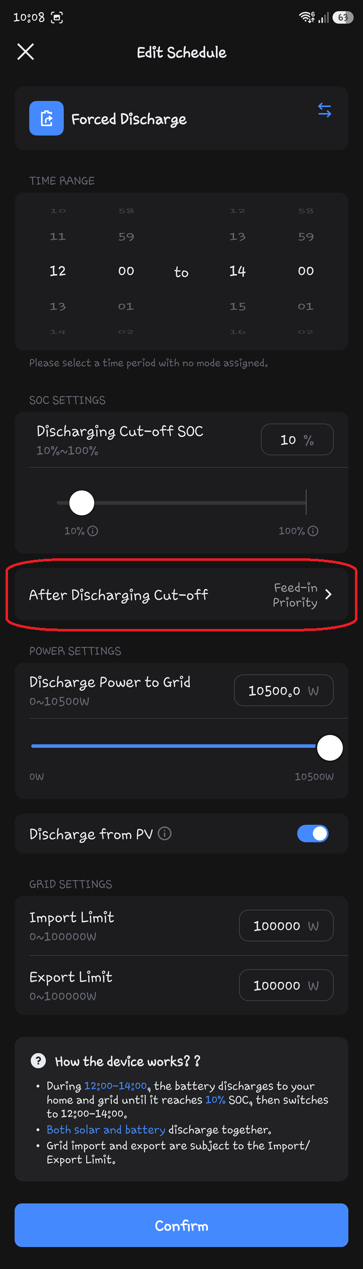

Regarding your register: First of all check if you can read in the value, next would be to create in the FoxCloud2.0 App a schedule as shown below with the PV toggle on. Read the register again when the schedule is active. Then enter the schedule, and toggle the PV switch off, and check the register address after saving the schedule.
So hopefully in testing, you will see the register change if AI has got the right one, and then you can create a quick test script to write the 'off' value and see if your PV output drops to zero.
