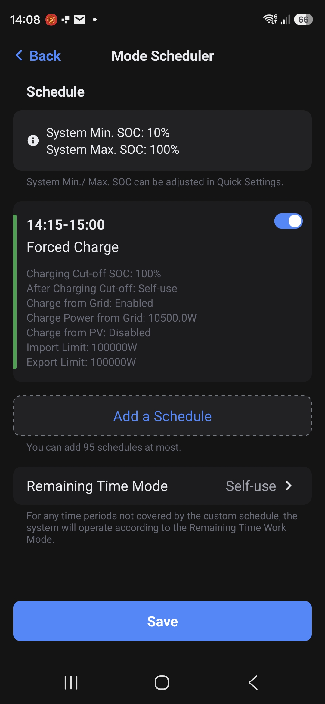

Regarding your register: First of all check if you can read in the value, next would be to create in the FoxCloud2.0 App a schedule as shown below with the PV toggle on. Read the register again when the schedule is active. Then enter the schedule, and toggle the PV switch off, and check the register address after saving the schedule.
So hopefully in testing, you will see the register change if AI has got the right one, and then you can create a quick test script to write the 'off' value and see if your PV output drops to zero.

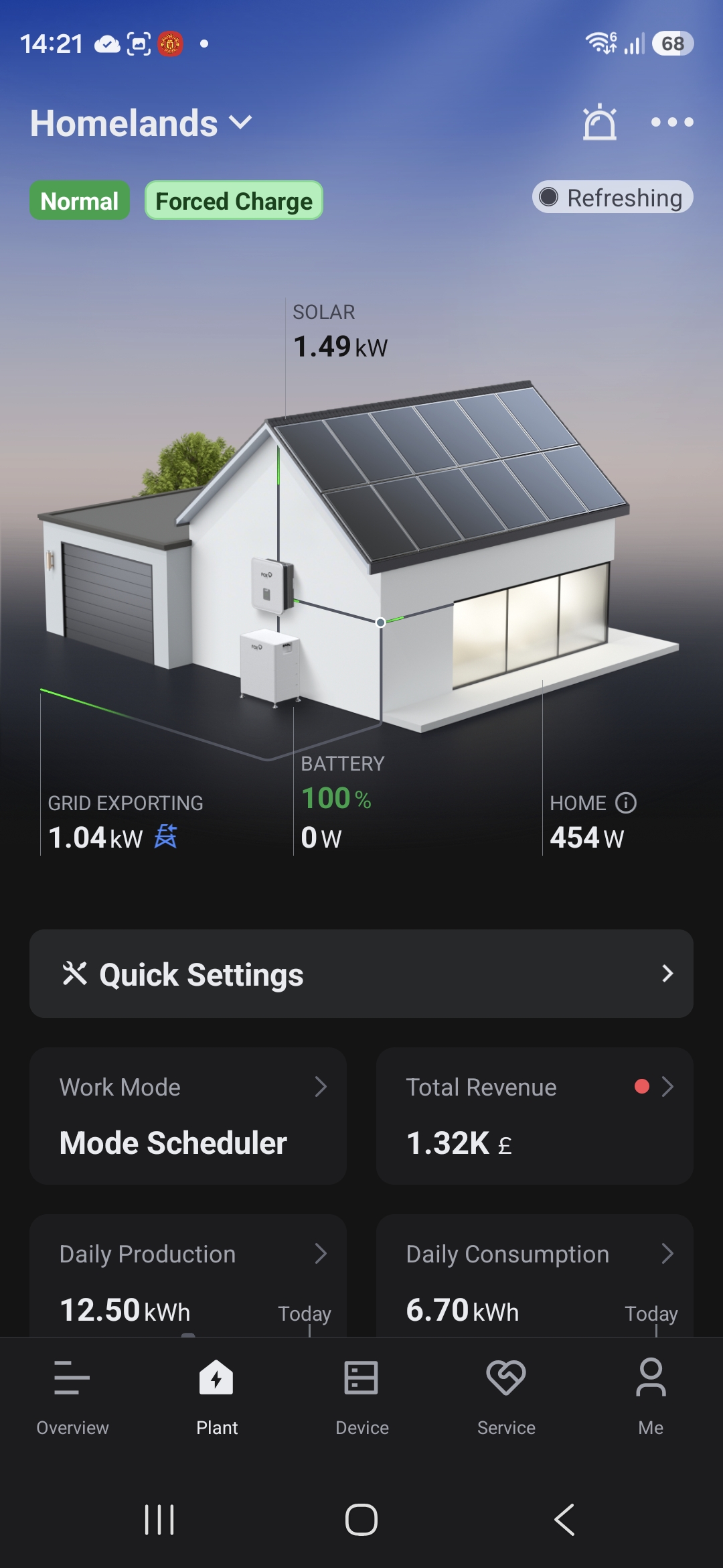

Fell as the first hurdle - I can get a schedule to kick in on the cloud app except that it doesn't actually do what the schedule is set for and then when SOC reached target of 100% it didn't revert back to self-use. Instead it started exporting surplus PV to the grid despite Max Export Power being restricted to 100W.
Now I'm not sure if it's the Scheduler or me not configuring it correctly?

Perhaps it's a firmware bug, the disabled PV charging is ignored?
Just found another member who wanted to do the same thing and Will (admin) responded saying PV generation can only be stopped by manually switching off the PV isolators
So why is there an option for it in the mode scheduler?

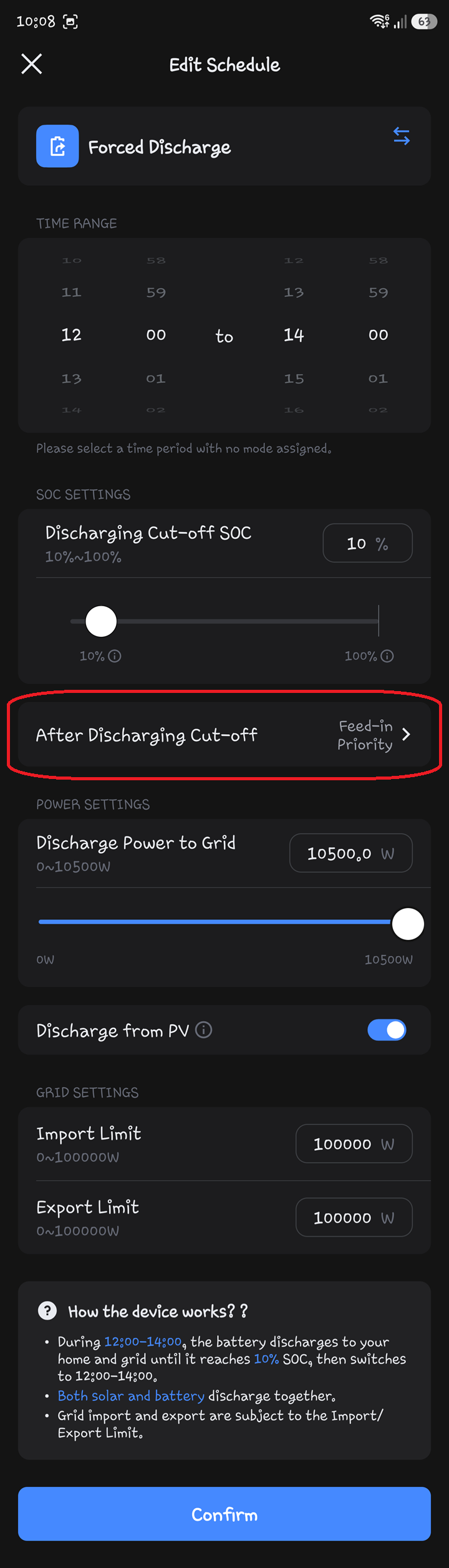

I don't know why it was added to the App, it could be a feature that does not yet work as intended. So it might need a FW upgrade not yet baked.
The feature we have now, on what to do when the SoC reaches xx% is something that depends on firmware. The red highlighted choice in my image. If you have a FW version too low, that choice doesn't show in the App for you.
A few more months, and it could be a working option?
