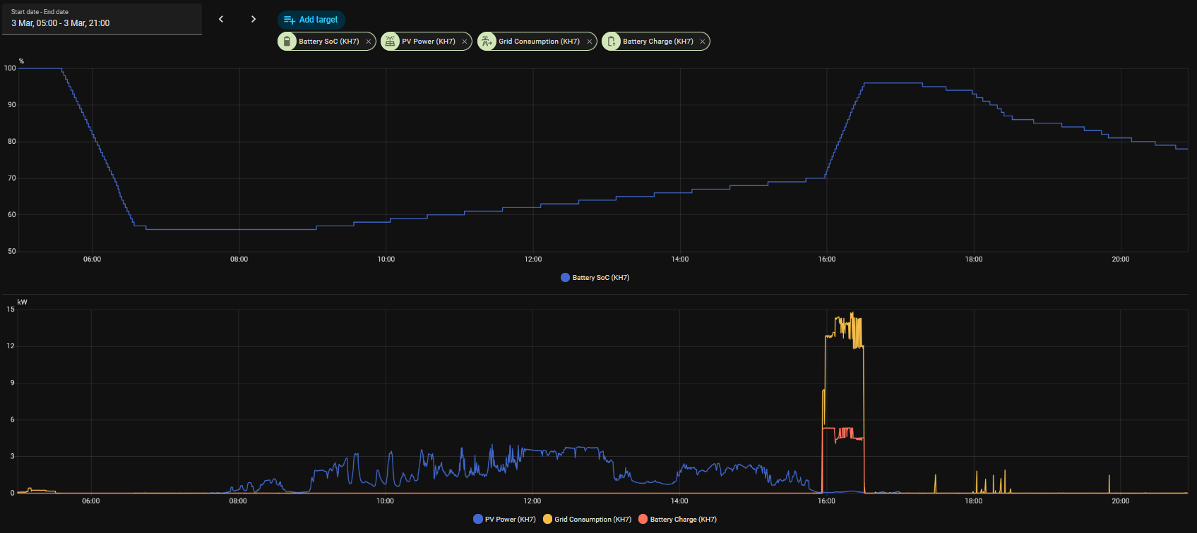

The KH inverters also 'leak' power into the battery, that is not accounted for, this can skew calculations also.
56% -> 70% (Inverter was in 'Feed-in' work mode in this example)
