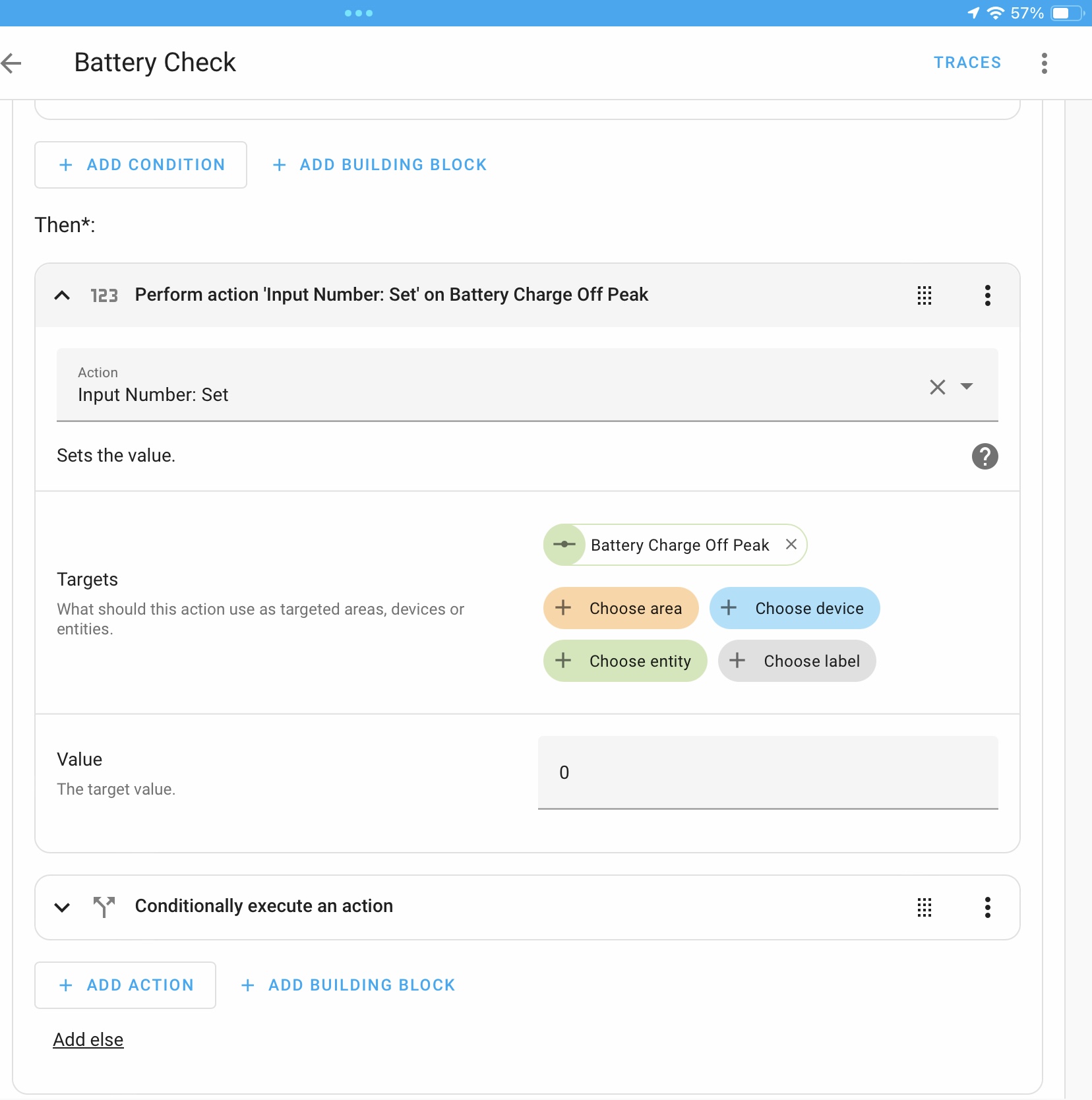

- Posts: 1855
Settings, Devices & Services, Helpers
You can create lots of things but you seem to need numbers, booleans, toggles(switches) they are global within your system, so you can see them on the dashboard, you can modify or set a value with actions in automations, or test them in conditions.
This is from one of my automations, which sets the ‘number’ helper called Battery Charge Off Peak to a value of 0
You can set it to a value of a state but you’ll have to use something called jinja templates for that - in the above example, lets say I wanted to set it to the value contained in sensor.battery_soc in the value box you would enter this template
"{{ (states('sensor.battery_soc')|int ) }}"
You can test templates if you go to Developer Tools, Template and enter the text you want to check in the Template Editor, and in the Results box it will show you how it evaluates.
Just post up if you need a hand with anything.
