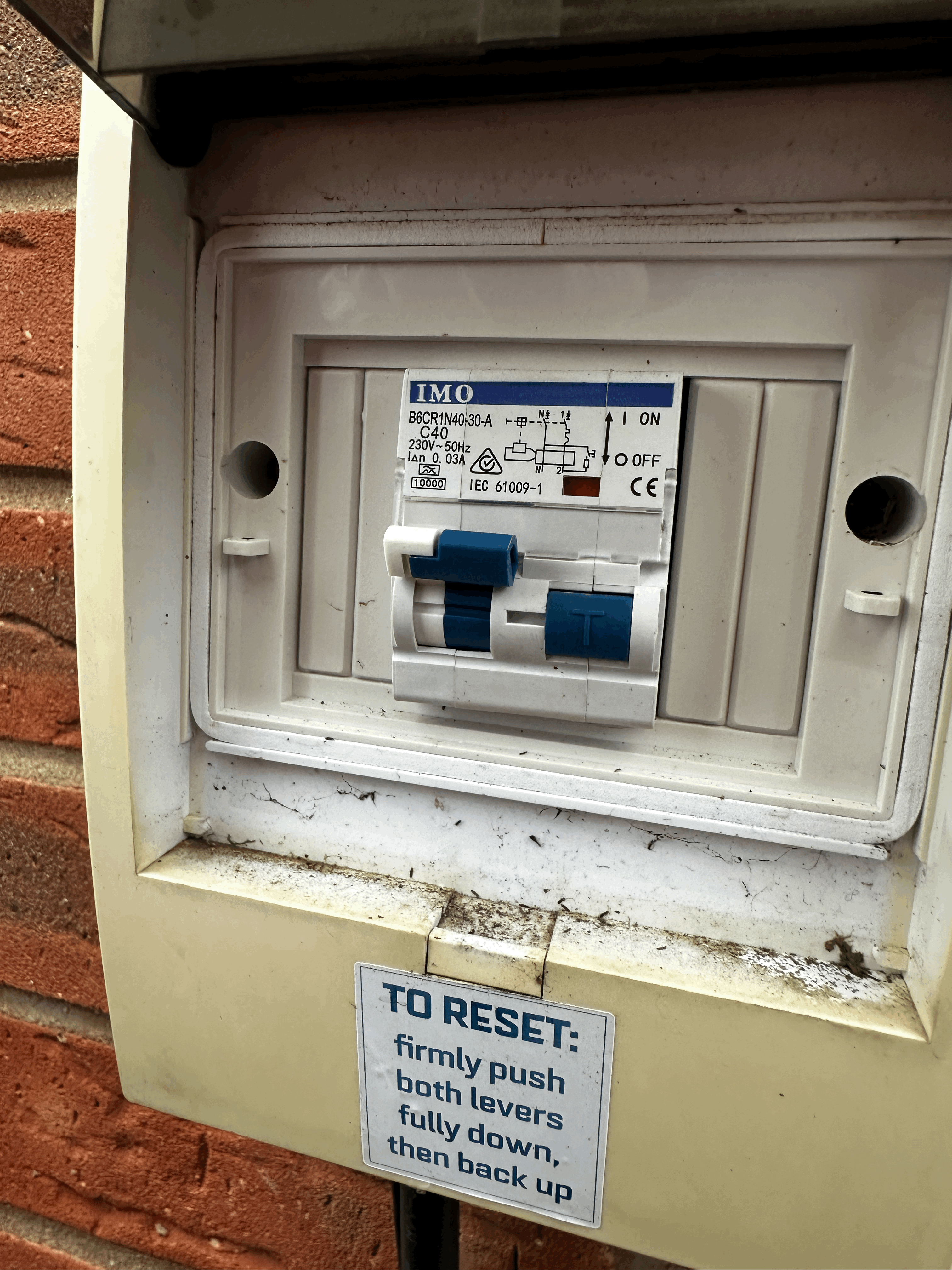

I need to do something similar with my PodPoint. The PodPoint does have a cloud integration where I can tell if it's charging, but the cloud part is a bit dodgy and sometimes the charge point drops off the WiFi.
Ideally I want to connect a Zigbee CT clamp to monitor it. But ironically I don't actually have an easy way to power that. The charge is outside next to the meter box. I do have another EV charger, a SolaX which has a local home assistant integration that reports charge power. So I may just use that, but it's not in a convenient location compared to the PodPoint.
Some other things I want to automate are the tariff. Theres an IOG dispatching sensor in the octopus integration, but from what I gather even if you're allocated a slot, you need to confirm the car is actually charging in order for that half hour slot for it to be charged at the low rate. I have seen instances where the car charges earlier and the house load was then charged at the peak rate. You get the guaranteed slot always between 23:30 - 5:30. What I have considered doing as a quick fix would be to limit the battery discharge to 3A when the intelligent dispatching sensor is on, but not the offpeak sensor. It should work until I can sort out a ct clamp solution! Once both sensors are off I can switch it back up to full discharge.

I have considered the mini consumer unit next to the charger, but unfortunately there isn't any space in there either. Ideally I don't want the hassle and expense of putting in a larger mini consumer unit.
I do have power the other side of the wall in the kitchen that would be easy to tap into if needs be, but would rather not drill more holes in the wall! I know the podpoint has 12v pins I could potentially power an esp32 from with a ct clamp, would be nice and tidy inside the unit that way. The clamp I have currently is 240v.

Actually looks like I was wrong, there is space in the mini consumer unit.
The MCB reset button also doesn't work anymore either, so probably a good idea to get a spark round to switch the MCB and maybe install something like a Shelly EM too!

The Shelly EM is tiny. The CT clamp is actually bigger - but still small. One thing to consider is that it's unlikely that any WiFi device will work inside a steel enclosure. I knocked out a whatever they are called 20 mm disc in my CU and fitted the Shelley EM in a plastic box next to the CU. That way there are no nasty live connections exposed but the WiFi is free to do its thing.

adamlc
Posts: 13
Joined: Thu Sep 26, 2024 10:49 am
This is a crappy plastic enclosure. Ideally I'd like a zigbee device as I have zigbee lights outside and the network is better than the wifi outside.
Ideally I'd get my wiring changed so the inverter doesn't see the charger. I guess getting this costed first makes the most sense!
It should just be a case of splitting the feed again in an extra henley block. Might not be too extensive 🤞
