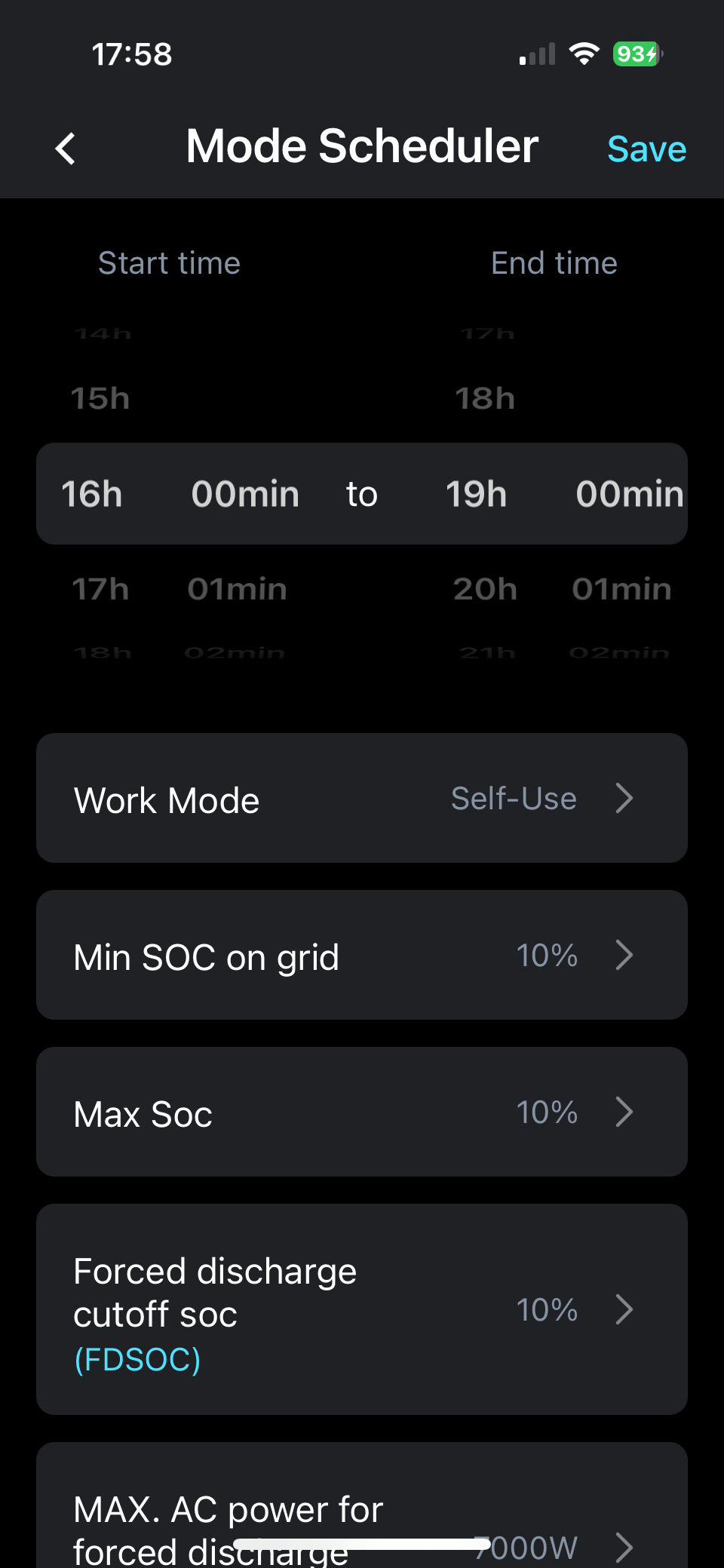

I have set up mode schedule as below, but they don’t all work as I hoped, the batteries charged at night but then started to be used during the day, I stopped this by changing the battery reserve capa to 100%.
When 16:00 came I had to manually changed this to 10% to used the batteries as I had planned.
I’m not sure what I have done wrong with the programming but any help would be appreciated

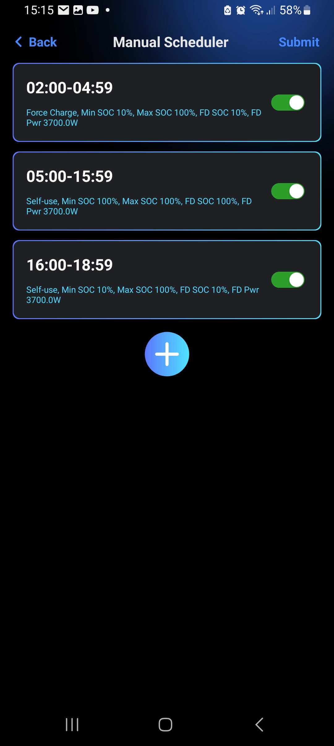

I'm not seeing a huge amount wrong but there is a time overlap which may be causing what you are seeing.
Your are correct that you need to set a Force Charge between 2am and 5am, then set Self Use with a minsoc at 100% between 5am and 4pm, then set a Self Use with minsoc at 10% between 7pm and midnight (Note: MinSoC will stay set to whatever the last schedule set until set again)
First thing to say is your schedules are overlapping because of the way they handle the seconds - when you set 02:00 to 05:00 what you are actually setting is 02:00:00 to 05:00:59 and that will then overlap the next setting from 05:00:00 to 16:00:59 and basically overwrite what you just set.
So you should set your Force Charge from 02:00 to 04:59 with minSoC on grid to 10%, MaxSoC to 100%, FDSoC and FDPwr are not valid for charge but must be set so choose 10% and 0 for FDPwr
On the next schedule set your Self Use from 05:00 to 15:59 with minSoC on grid set to 100%, MaxSoc to 100%, again FDSoC and FDPwr are not valid but must be set so choose 10% and 0 for FDPwr
On the last schedule set your Self Use from 16:00 to 18:59 with minSoC on grid set to 10%, MaxSoc to 100%, again FD SoC and FDPwr are not valid but must be set so choose 10% and 0 for FDPwr
Make sure they are all enabled with the slider for each to the right and that should be that.
Thank you, i will try this out.

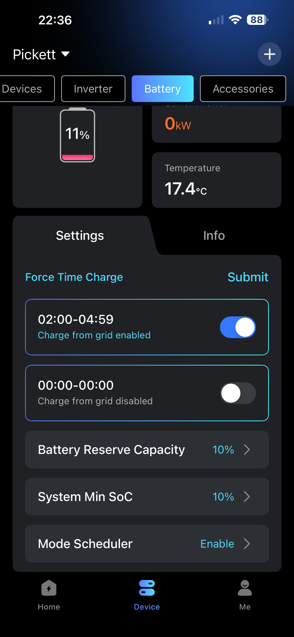

just 2 other questions, do i need to add a schedule from 19;00 to 02;00 as i haven't put any thing in for that time period ?
Also do i need to change anything on the battery page, ie battery reserve cap or System Min SOC ?
No you don't need anything else after the 4pm-7pm schedule - the inverter will follow the last minSoC setting made and as it was set to 10% it will simply run on batteries for as long as they have charge until it gets to 2am in the morning when they charge again and the cycle repeats.
And no you don't need to change any of the other battery settings - the Battery Reserve will follow the MinSoC setting you set in the schedule - it won't let you change that whilst a schedule is enabled, and the system minSoC is correct at 10%.
The Force Time Charge periods you see there cannot be used when using the scheduler, it's one or the other - when the scheduler is enabled it will reset both to 00:00 and turn them off. The scheduler is more powerful as it offers up to 8 possible actions in a day and I suspect in future these 'older' time periods will be removed as they cause confusion.
Thank you Dave, it worked as it should.

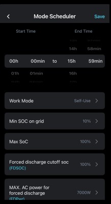

Hi Dave, hope you could help me again please.
I would like to change the schedules but not sure what I have to do, I would like the following.
All day I would like solar to charge the battery - then use solar or grid, I don’t want to charge the battery from the grid or use the battery
From 4pm onwards if no solar I would like to use the battery until its run down to 10%
Any help would be much appreciated

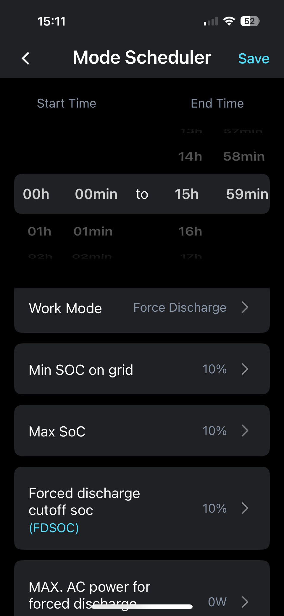

Morning Dave, I’ve checked but I don’t have work mode back up, I’ve tried putting in a few scheduled but none have been successful
This is the settings I’m using at present
As soon as Solar reduces the load comes from the battery, this is the bit I’m not sure what I change in the mode schedule to stop the battery from being used during this time period
For the period where you want to charge the battery and not allow discharge, try this schedule:
Force Discharge, Min SOC 10%, max SOC 10%, FDSOC 10%, FDPwr 0w
This seems counter productive but despite being a Force discharge as the FDPwr is set to 0 it won’t allow discharge but should allow solar charge.
Thank you for the reply,
I have tried this setting and it looks like pv is just charging the battery and the load is from the grid What would need changing so I use the pv and any pv left would charge the batteries
Without the backup work mode the only way to charge the batteries from solar is to use Self-Use but as you say when solar drops off the batteries will discharge - probably not a problem in the summer months as solar would likely always be high enough to cover the house load.
If you had home assistant and modbus control you could do it but using schedules you’ve only got self use or the force discharge method I mentioned.
The only other option is to set to self use and the minsoc to 100% which will slowly charge the batteries, and not allow discharge but you’ll need a reasonable amount of solar(2kw) to cover the slow charge and your house loads - perhaps try that and see if that suits what your trying to do but as I said it’s all a bit of a compromise.

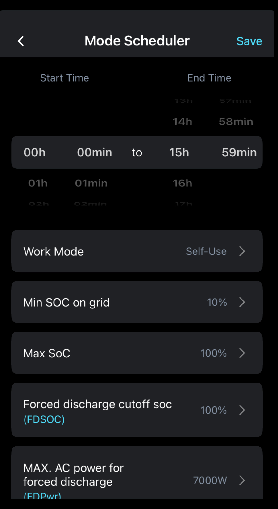

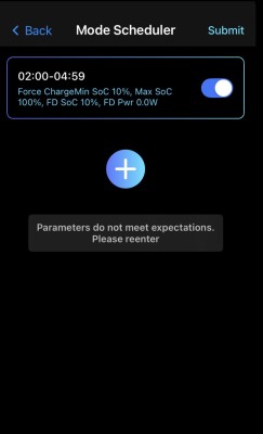

Hi Dave,
It’s been a while but I’m having issues with mode schedule again, I’m putting in the same details as I used last winter but no matter what I change I get the same issue. “ Parameter do not meet expectations Please reenter “
I can change the work mode, max soc, force discharge , max ac power but none of this works
I have also tried force time charge
But this always says write failed.
Its like I cant make any changes and have no control , hope you can help again
Thanks Hayden
Thanks Hayden

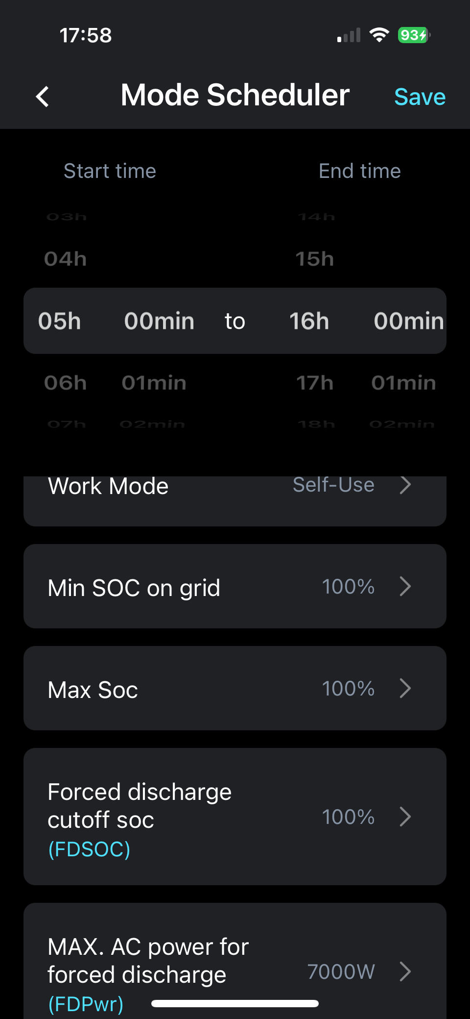

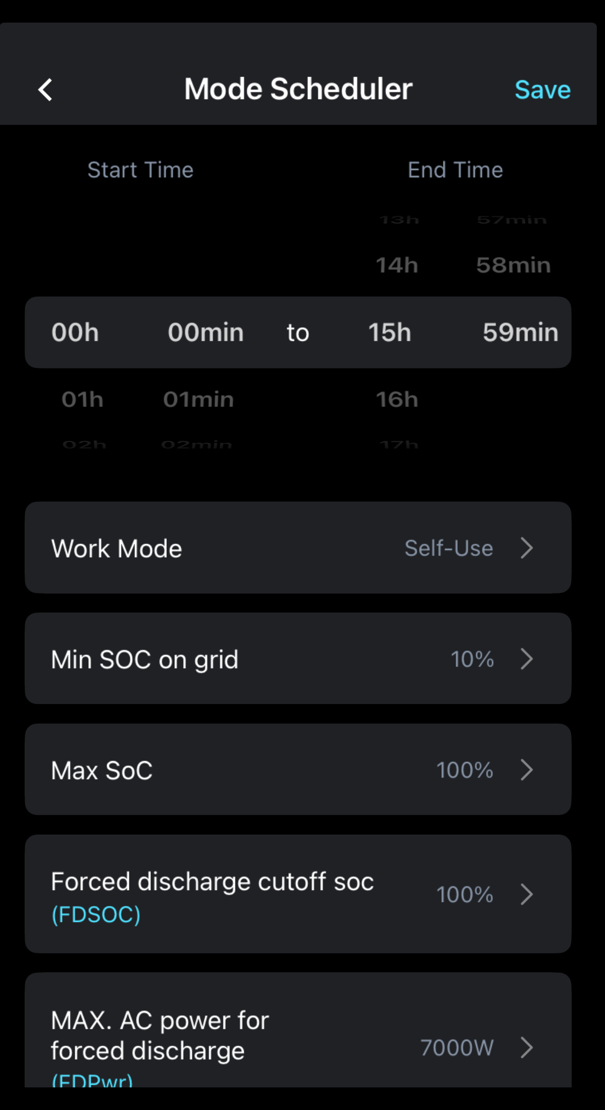

Seems you must have had your firmware updated during the year, the functions of FDSoC and FD Pwr have changed in that they affect force charging as well as discharge.
Set FDSoC to 100% and FD Pwr to your inverter's output power and hopefully you should be good to go.

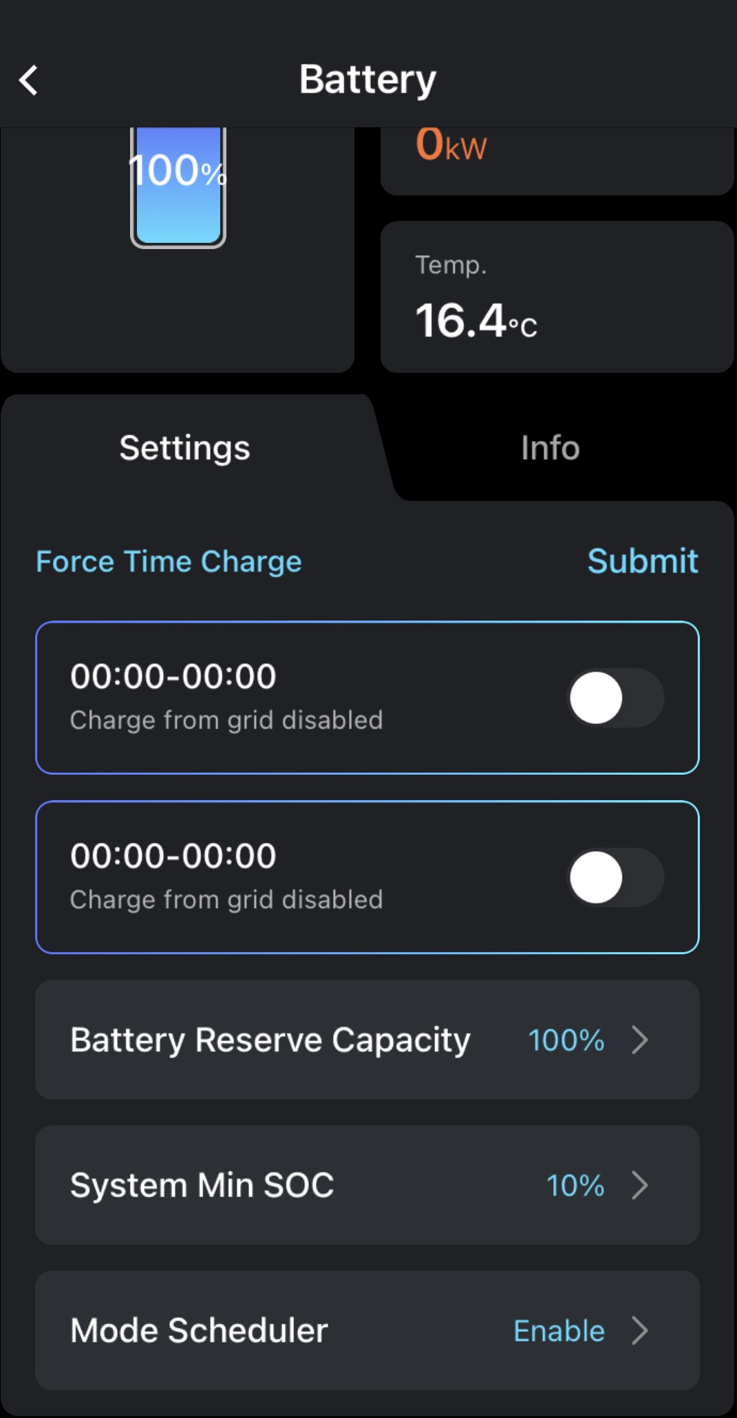

thank you for your reply, but that didn't work, i still get the same message, “ Parameter do not meet expectations Please reenter “
i have played around trying different work modes, min SoC, Max Soc forced discharge and ac power but it makes no difference. i still get the same message
If it isn't allowing you to change settings, it's possible your Manager has crashed - the only way to fix that is to shut down the system and restart (if you haven't done that before there is a video here in guides that can help).
Basically you have to switch off the DC (PV) isolator, AC isolator (or breaker), then power off the batteries and open the dc switch on them (a breaker like device on the battery).
wait until the inverter screen goes blank and then restart by turning the batteries back on (breaker on, press the power button), AC back on, DC (PV) back on.

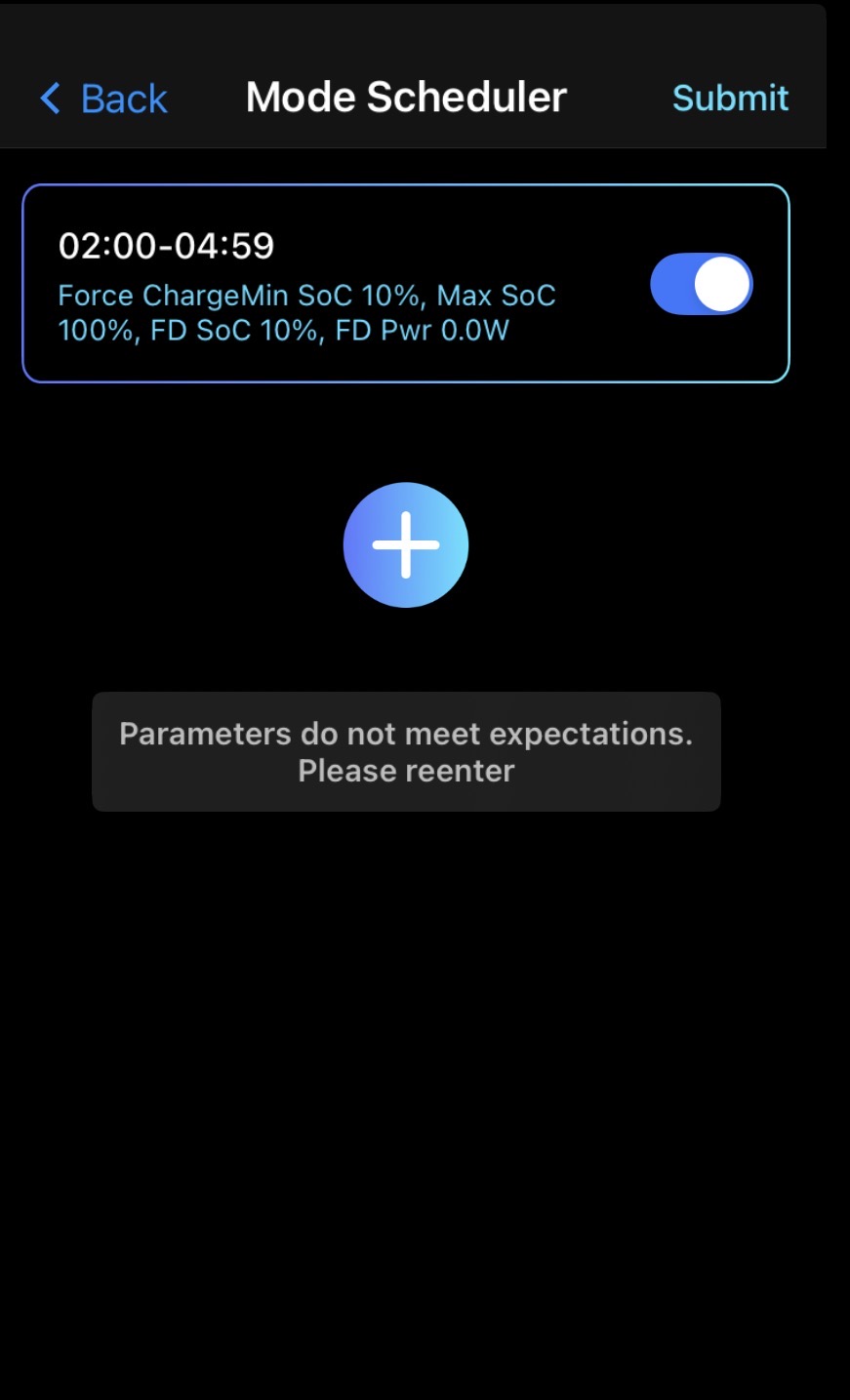

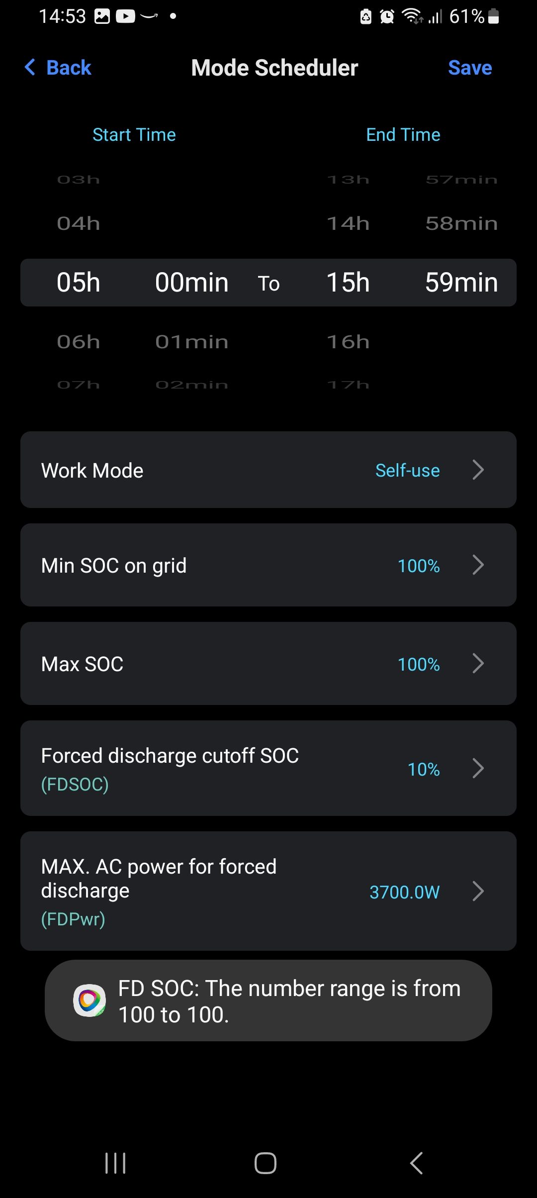

Thanks in advance to David for the step by step explanation.
I have set up mine exactly as explained but in the second step it did not allow me to set the FDSOC at 10%. It would only let me save 100% as the value. I've attached a screenshot.
I assume this is the why the battery is being charged from the grid now (between 05:00 and 15:59) which is not what we want!
Any thoughts please.
Thanks.

What are you trying to do with your 3 time settings,Alligator wrote: ↑Sun Oct 19, 2025 3:31 pm Thanks in advance to David for the step by step explanation.
Thanks.

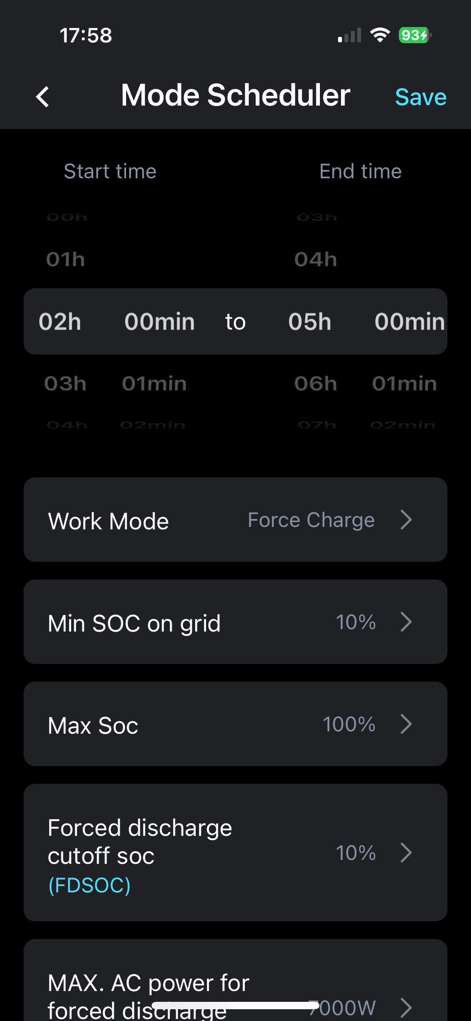

On the 1st time period I would recommend setting your FDSoC to 100% (when/if you have latest firmware you will need this)
On the 2nd time period you have set minSoC to 100% which will slow charge the battery and not allow discharge - that's also the reason why it won't let you set FDSoC below 100 as it cannot be any lower than minSoC.
Not sure what the 3rd time period is doing, should that be a forced discharge workmode instead ?

I have just had installed a Fox Evo 10kWh battery with hybrid inverter, plus a 12 panel solar array with kWp of about 5.8.
I have now been moved to the Octopus Flux tariff (it seems that Fox batteries are not yet approved for Intelligent Flux) and I would like to set up my Evo to do the following:
02am to 04.59am charge the battery at the low rate
05am to 15.59pm use the solar and battery to power the house
16pm to 18.59pm sell power back to the grid until the battery has remaining charge of say 40%.
I have read through the questions and answers on this topic but remain confused!
A step by step instruction set would be much appreciated; my apologies for having to ask.
Have a look at this video which will explain much of what you are looking for. https://foxesscommunity.com/viewtopic. ... 011#p10011
Essentially you will set 3 schedules
02:00-04:59 Force Charge, minSoC 10%, maxSoC 100%, FDSoc 100%, FDPwr 10000
That will force charge your batteries to 100% at maximum charge rate.
The second schedule is
05:00-15:59 Self Use, minSoC 10%, maxSoC 100%, FDSoC 100%, FDPwr 10000
That will switch the inverter to Self Use and so the inverter will prioritise solar power for House Load, Battery and if there is not enough solar the battery will be used to fill in.
The third schedule is
16:00-18:59 Force Discharge, minSoc 10%, maxSoC 100%, FDSoC 40%, FDPwr 3000
That will discharge the batteries at 3000 watts, house load os taken first and any excess is exported to the grid - it will do that until the battery hits 40%
(Change the 3000 watts to your desired level if you want to discharge faster or slower)
