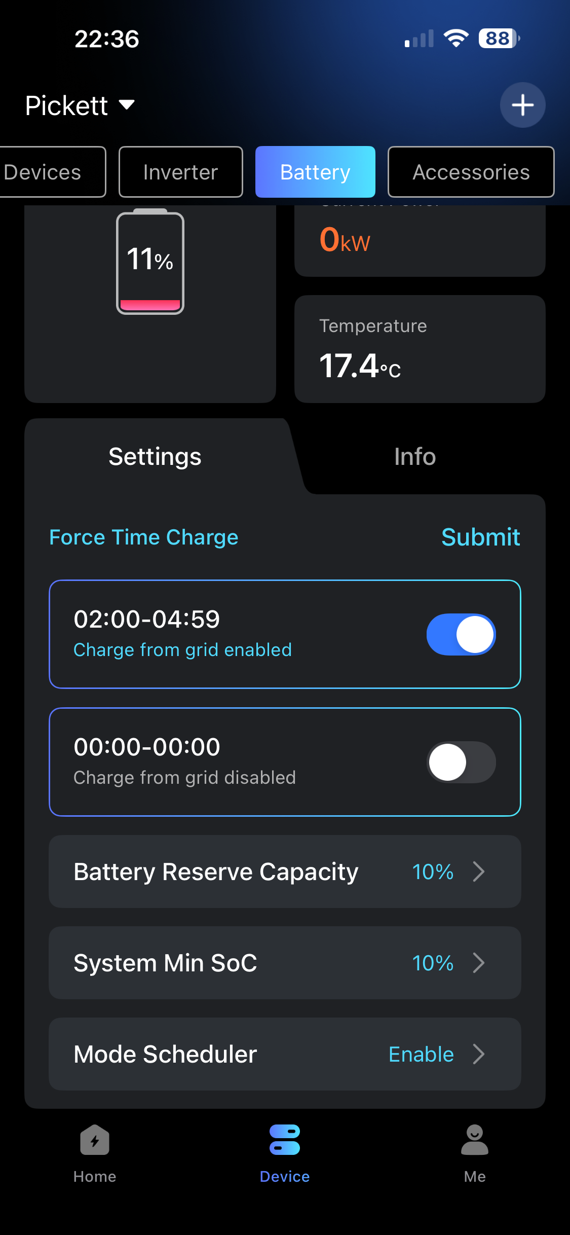

Re: Mode Schedule
Alligator wrote: Sun Oct 19, 2025 3:31 pm Thanks in advance to David for the step by step explanation.
I have set up mine exactly as explained but in the second step it did not allow me to set the FDSOC at 10%. It would only let me save 100% as the value. I've attached a screenshot.
I assume this is the why the battery is being charged from the grid now (between 05:00 and 15:59) which is not what we want!
Any thoughts please.
Thanks.
What are you trying to do with your 3 time settings,
On the 1st time period I would recommend setting your FDSoC to 100% (when/if you have latest firmware you will need this)
On the 2nd time period you have set minSoC to 100% which will slow charge the battery and not allow discharge - that's also the reason why it won't let you set FDSoC below 100 as it cannot be any lower than minSoC.
Not sure what the 3rd time period is doing, should that be a forced discharge workmode instead ?
