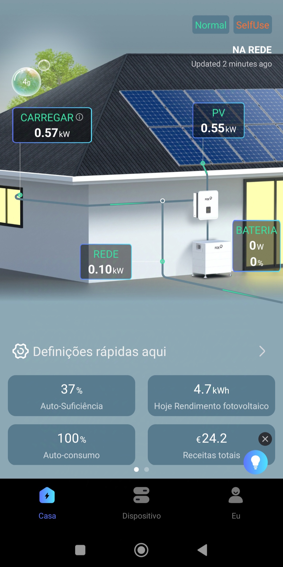

I have a photovoltaic system with 6 525 W panels and a FoxESS H1-3.0-E inverter installed, but no batteries.
At the moment, the application does not display the total production of the panels, but only the value according to what I consume.
My question is the following:
- Is it possible to check in the FoxESS application what the panels are actually producing in total?
- In the inverter, what are the necessary settings to be able to display the power actually produced?

Note that the power consumed is equal to what the panel is producing.
It's a beautiful sunny day and the panel should be showing the maximum power produced.

So lots of questions,
is the Fox inverter fitted with a CT clamp (or meter) and is that attached on the feed from your grid meter ? and is the Meter/CT enabled in the inverter settings ? - this is essential for correct operation of the inverter
Do you have an export limit set in the inverter settings (it appears so as this would restrict PV to load)
Just to confirm it looks as if you have no battery fitted.

The inverter has a meter and is enabled as "CT".
The export limit is set to 00000.
I don't have batteries installed.

As you have set an export power of 0 the inverter will only ever output at the same power as the load - without a battery or export there is nowhere for the extra power to go - the inverter cannot generate power unless it has a consumer for it.
