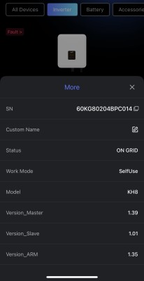

Here’s a pic with the details of our inverter model. It is sited in a garage so well sheltered from direct sun.
Is the firmware out of date? Will updating that sort the issue?

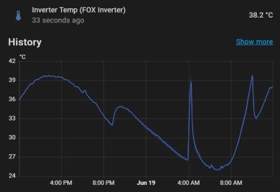

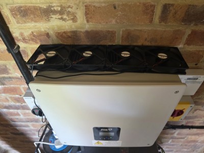

As Dave has said .. they get hot when generating ... I have added a few fans on top, pulling the heat away from the unit. I actually have these connected to a "smart" plug .... and Home Assistant to automate so they come on when temp reaches a certain limit. You can see on my graph, where the fan has kicked in
It's surprising just how effective a couple of computer fans is at reducing the heat.
I got a pair of 140mm computer fans on USB, the total power draw is only 4W on high, but it drops the inverter temp down to below 40c even in this heat. KH7. Have to say that I have never noticed it making any noise, however. Quite a bit more effective than the 50W pedestal fan which I programmed to go off at 45c. It hasn't turned on ever since I added the computer fans, but when it did turn on, it doesn't reduce the temps as much as the computer fans.
Keeping the temp low is good - they derate if it gets too hot, and the components should last better. Personally I didn't put that one on a smart plug, on the basis that it's only 4W. Also thermal cycling can be an issue for some electronics.
Are you using the USB connector on the inverter itself to power the fans?WyndStryke wrote: ↑Sat Jun 21, 2025 11:47 pm I got a pair of 140mm computer fans on USB, the total power draw is only 4W on high ...
No, I think that USB connector is for firmware updates and similar. It's using wall power.
