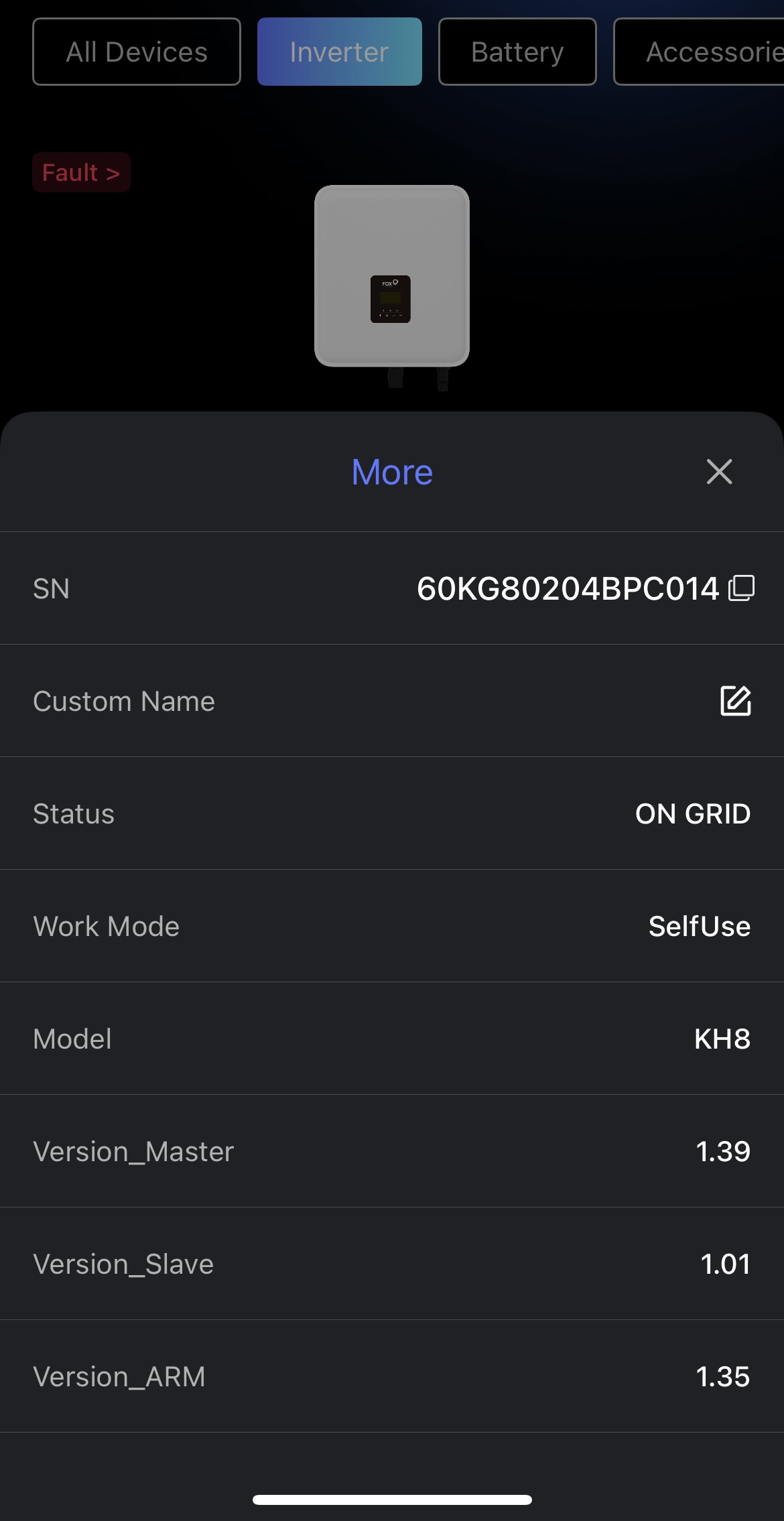

Here’s a pic with the details of our inverter model. It is sited in a garage so well sheltered from direct sun.
Is the firmware out of date? Will updating that sort the issue?
