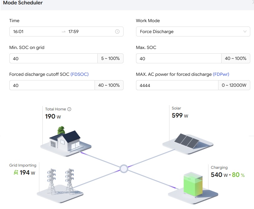

Given the sun today (yeay! :D) the battery is at 80% SoC, so I thought I'd schedule a discharge...
Something is definitely not right because the system changed from importing around 0 to 10W and pumping that and the rest of the solar into the battery to importing 194W !!! :shock: :shock: :shock: :roll:

I guess at this point you can be thankful it at least charged up, looking like a tasty bug at the moment.

Can you attach a screenshot of your Forced Charge schedule?
