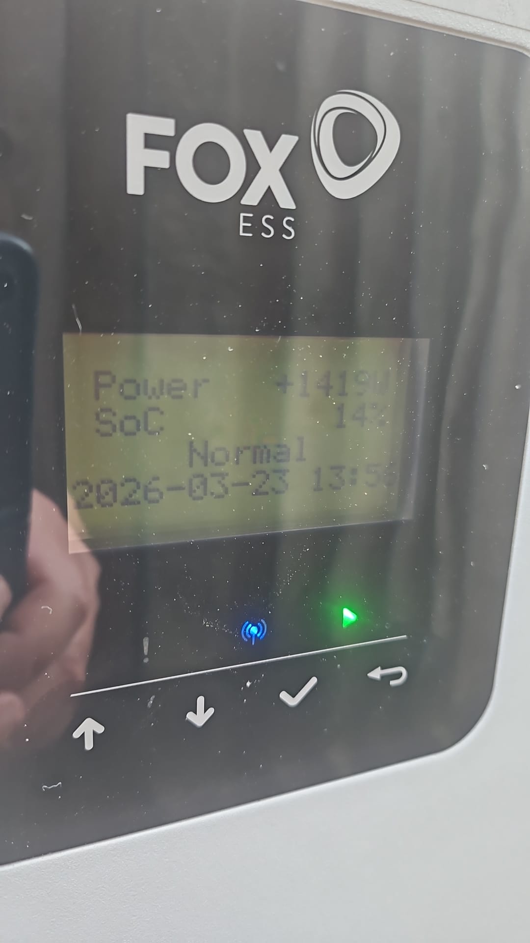

Attached are few photos, screenshots:
1. Real use in house right this moment -+178watts but not exactly 1.59kw
2. Inverter Screen
3. Smart Meter Display

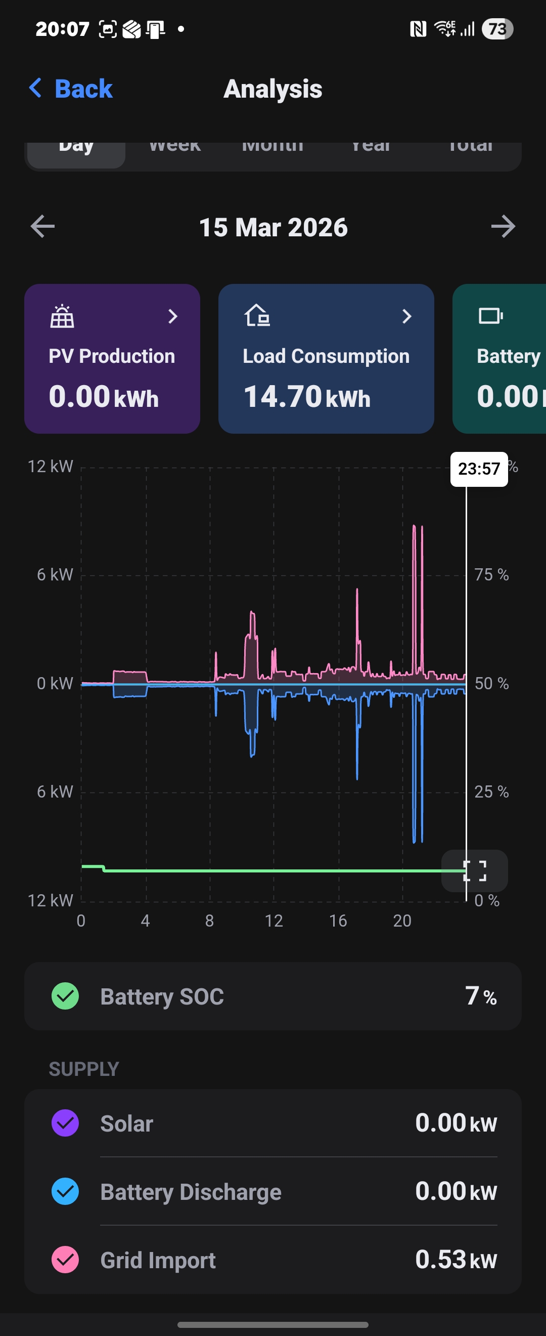

On your FoxCloud2.0 App, you can click on "Daily production" and it will show a power graph for the day.
Can you get a screenshot for yesterday and today please?

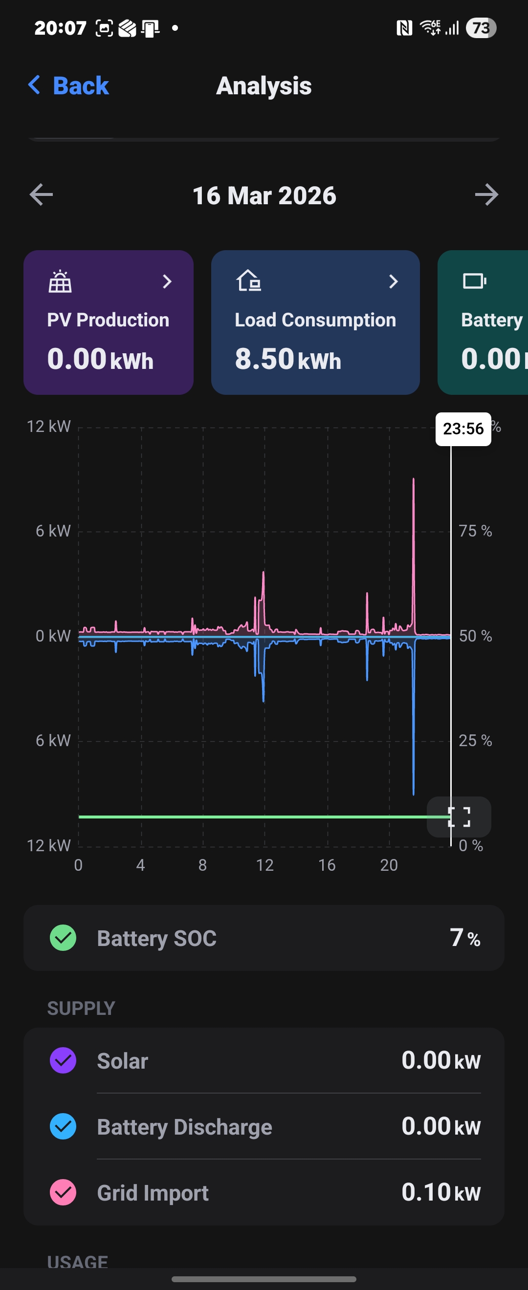

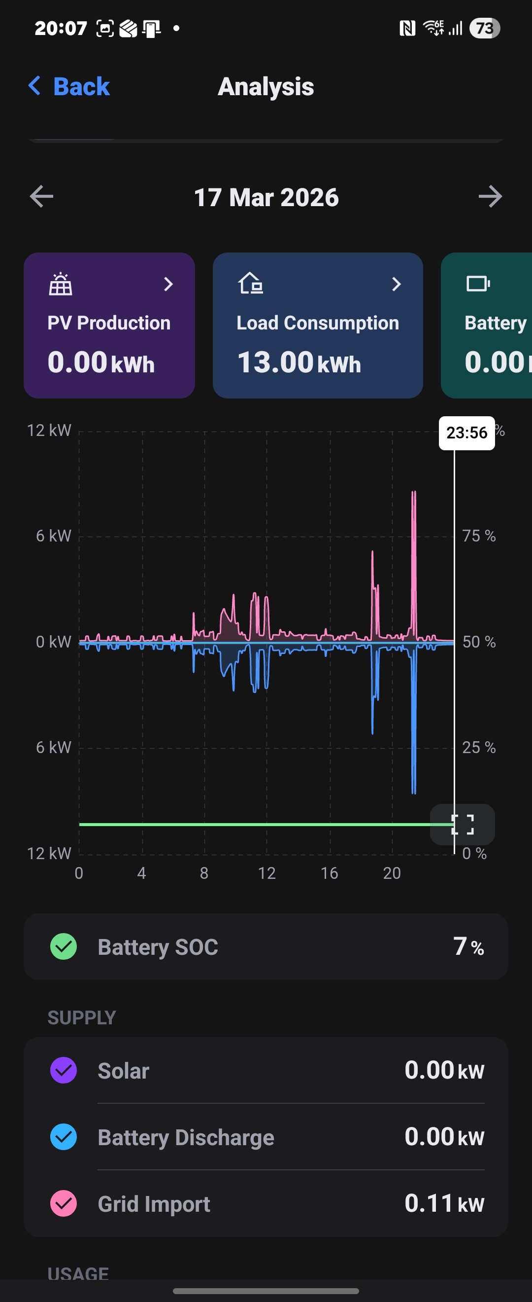

Of Couse, thanks. 23.03.2026 around 11:12 AM The Buttery charged up to 14% when switched off all fuses excluding main one.

Re: Buttery does not charge. Wrong usage data indicated in app.
I don't think your battery is charging much, as you don't have the best PV input, which you cannot control the weather.
And combined with your daily household power usage figures, you are draining it quicker than you are putting power in.
23rd
PV you made 6.70kWh
Load was 12kWh, so the battery would struggle to charge as there was not enough spare energy.
Do you know how big your solar array is?

In the last photo: What PV producing at 13:30 exactly

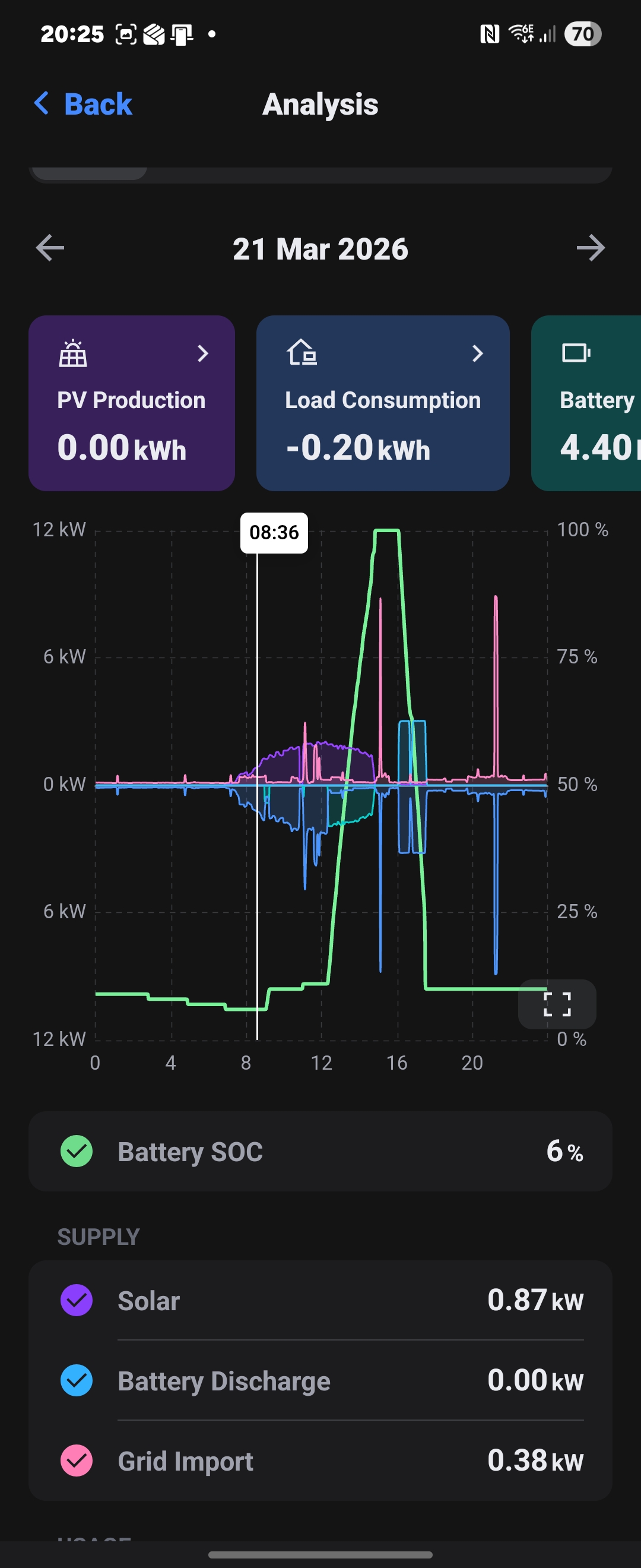

A graph for 21st would be best to show.
21.03.2026 We used Force Charge mode for testing, the battery charged up to full in about 2 hours and then suddenly leaked to nowhere, this for certain because right that moment we were using about 280watt. I was watching the leak happening life on screen 3.5Kw/H. As you can see until 11 AM the battery was not charging in Self Use mode.
In force Charge mode we switched OFF charging from grid that is why the battery was charging from Solar Panels only.
I do not know where it went, but it was a load in your home.
