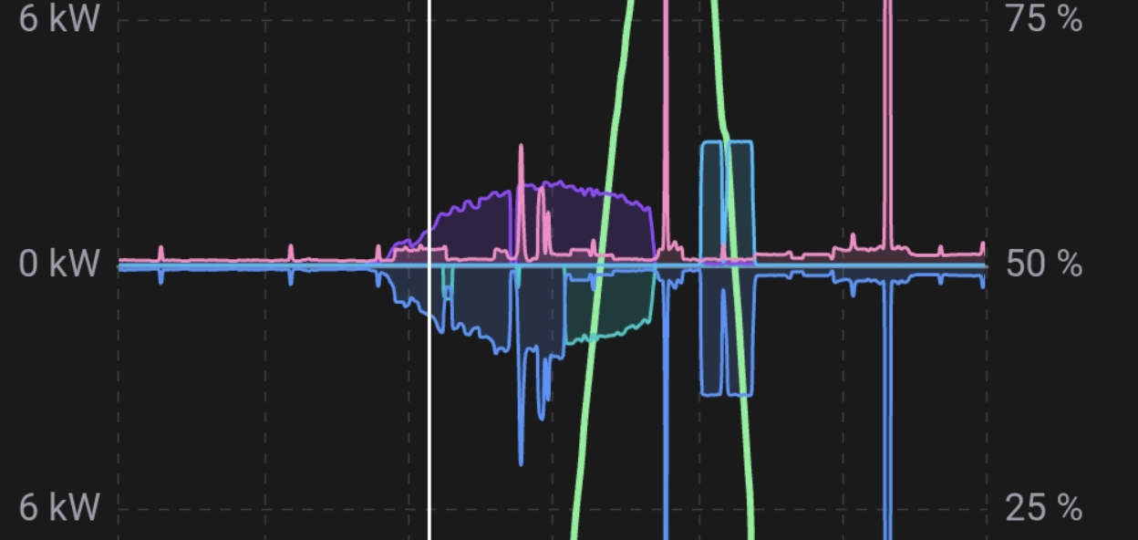

21.03.2026 We used Force Charge mode for testing, the battery charged up to full in about 2 hours and then suddenly leaked to nowhere, this for certain because right that moment we were using about 280watt. I was watching the leak happening life on screen 3.5Kw/H. As you can see until 11 AM the battery was not charging in Self Use mode.

In this picture you posted, you can see the purple PV power curve that increases and then comes down towards end of day. It looks like a rainbow shape.
Now what IS weird is your power usage below the 0kW line, is a mirror.
So the more you make solar, the more power your home uses!
I have to ask, do you have some power diversion device to heat hot water, or an EV charger that operates when it thinks it has excess electric?

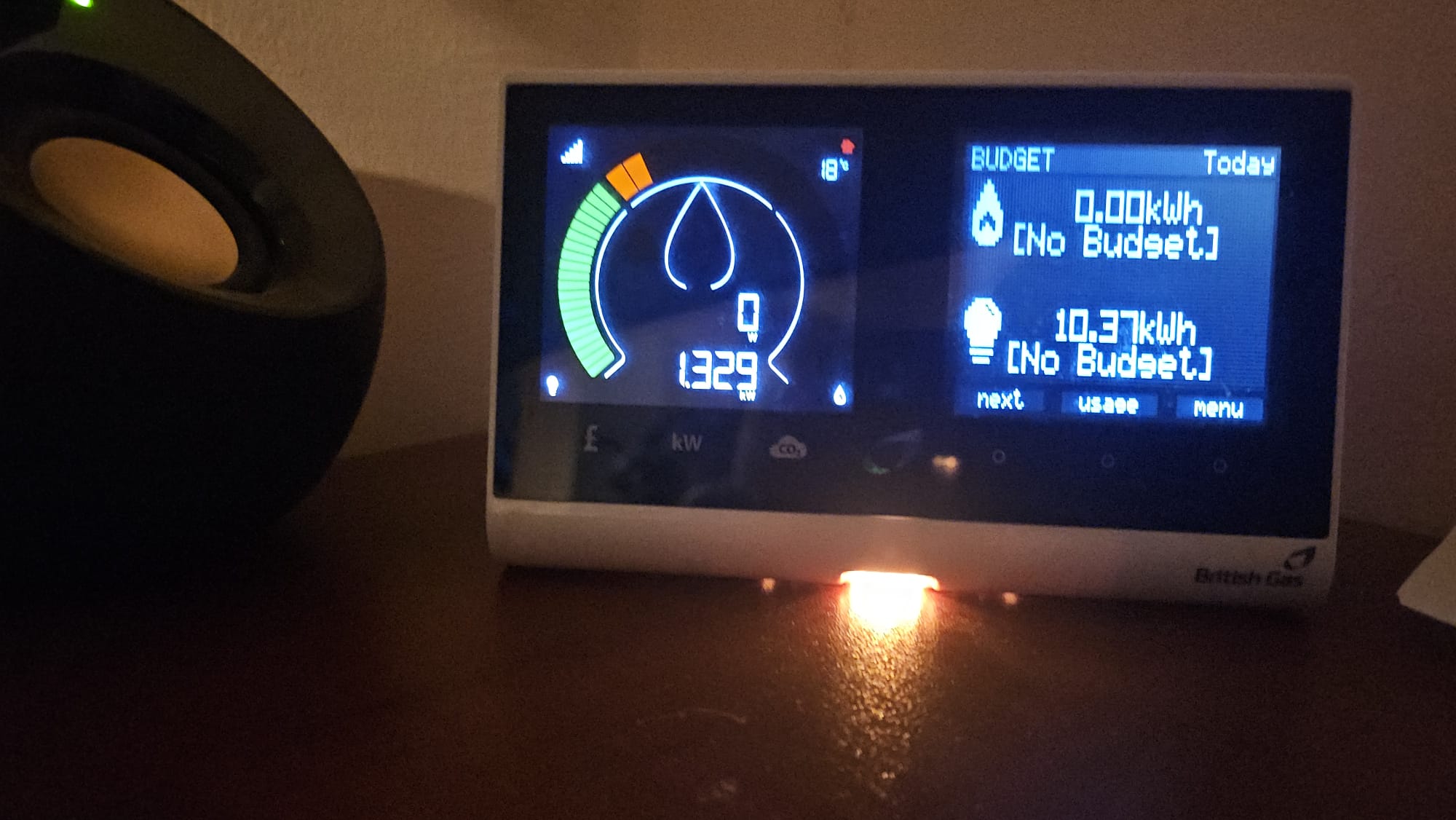

Heat pump uses max 1.5Kw at full capacity. But at this time the heat pump was off. No EV charge. ;) This Smart meter right now. This mx for the next 30 min then it drops to 340watt

If you look back to your picture from the 21st, you have selected 08:36 as a "point in time"
Now if you go back here, and this time move finger from 09:00 to 12:00, you will see as your PV increase in value, so do your load will keep increasing in a matching pattern.
Example: If your PV was 1kW, your load will be very close to 1kW. If your PV is 2kW, then your load becomes 2kW.
With some investigation in your home, you will find what is taking this "spare" power taking it away before your battery can charge up.

VicByron wrote: Tue Mar 24, 2026 9:03 pm Heat pump uses max 1.5Kw at full capacity. But at this time the heat pump was off. No EV charge. ;) This Smart meter right now. This mx for the next 30 min then it drops to 340watt
What does your FoxCloud2.0 App show for the same time as the smart meter time?
