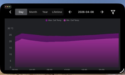

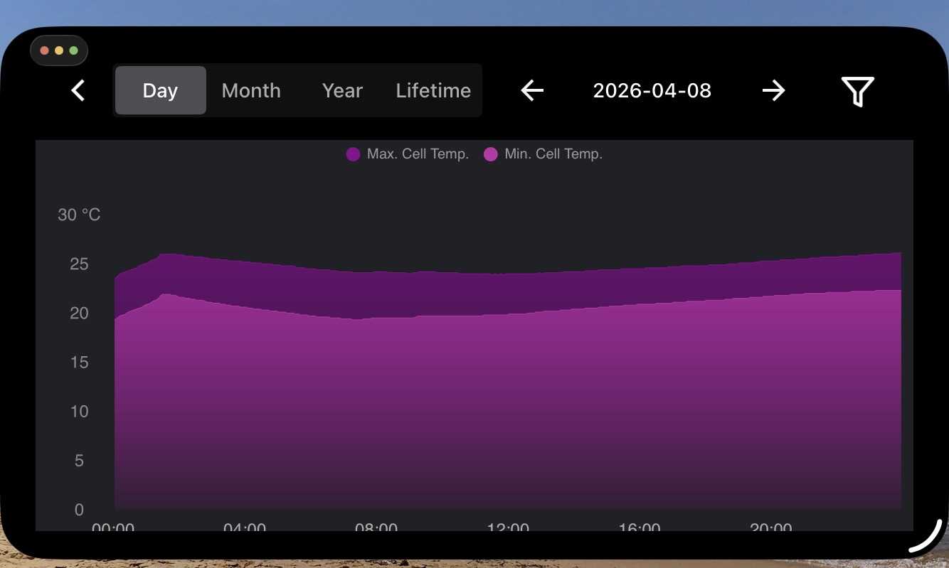

Due to the increased temperatures of the last few days, we had 27C yesterday, what is the max cell temperatures the battery is comfortable with.
If I can trust the inverter graph, I saw a max of 26.8C, and overnight into this morning, after forced charge 28.6C.
I still have my insulated cover on, so surprised the temperatures were not higher, but as the battery was fully charged all day and was just exporting, it was not actually doing much.
Just trying to work out when the cover comes off.
An insulated cover does a good job of keeping the heat in, and out - your temperatures are fine at the moment, the batteries are capacity rated at 25C and + 10C/-4C is in their sweet spot but they are easily capable of sustained operation at 40C (and are tested to that standard).CDubbs wrote: ↑Thu Apr 09, 2026 7:03 am One for the experts please.

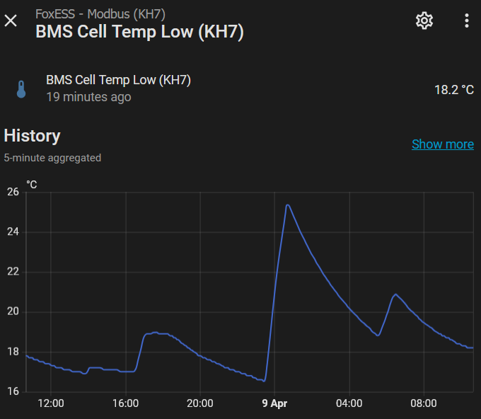

I made the mistake a couple of years ago of removing the insulation and unsurprisingly straight after we had a 3 day cold snap and the battery temps dropped below 15C. So now I typically start by opening the lid of my cover in early May, and then remove it all together towards the end of the month.
I removed my cover yesterday (the blanket!) and as mine sits in a garage, it does not fluctuate too much these days.
You can see the big spike last night for a charge (with cover off) and a smaller spike in the morning for a 1hr discharge. If it drops below 15°C then I will consider chucking on the blanket in a single layer
