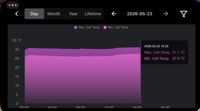

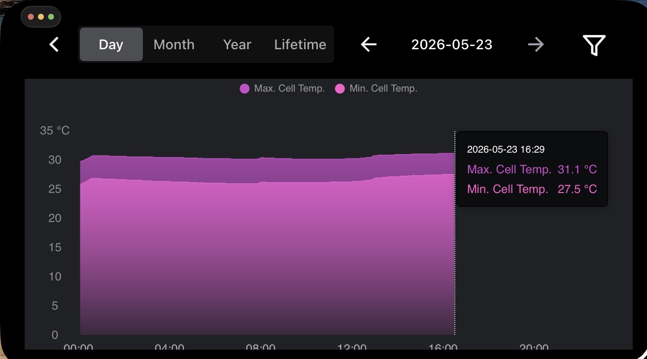

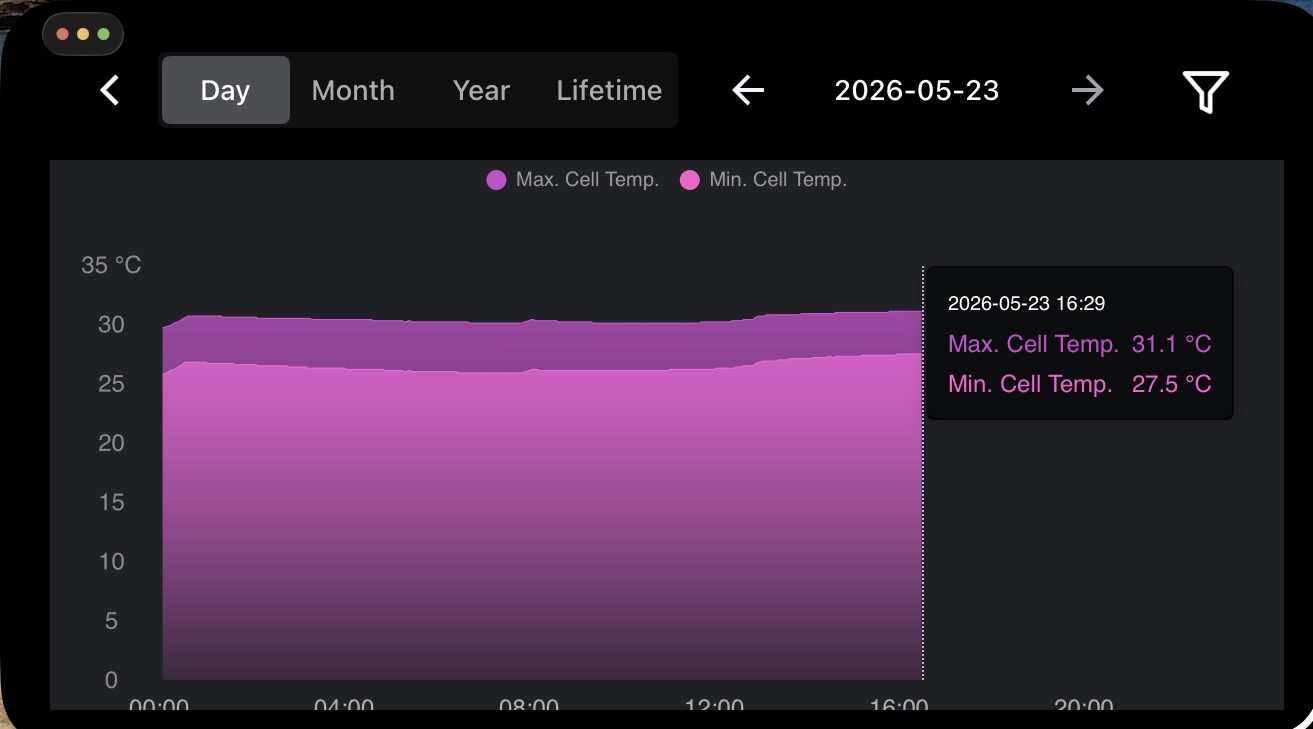

Hottest day since system fitted last September, got to believe the insulated cover is keeping temps in the cells down (as per Dave’s comment above )
I’ve got 2 covers, a metal one with 50mm Celotex around 80% of the interior, and another that fits over that made of 50mm Celotex and waterproofed.
Max cell temp today approx mirrors current external temp of around 30/31C
Can see it will be left on all year at this rate.
