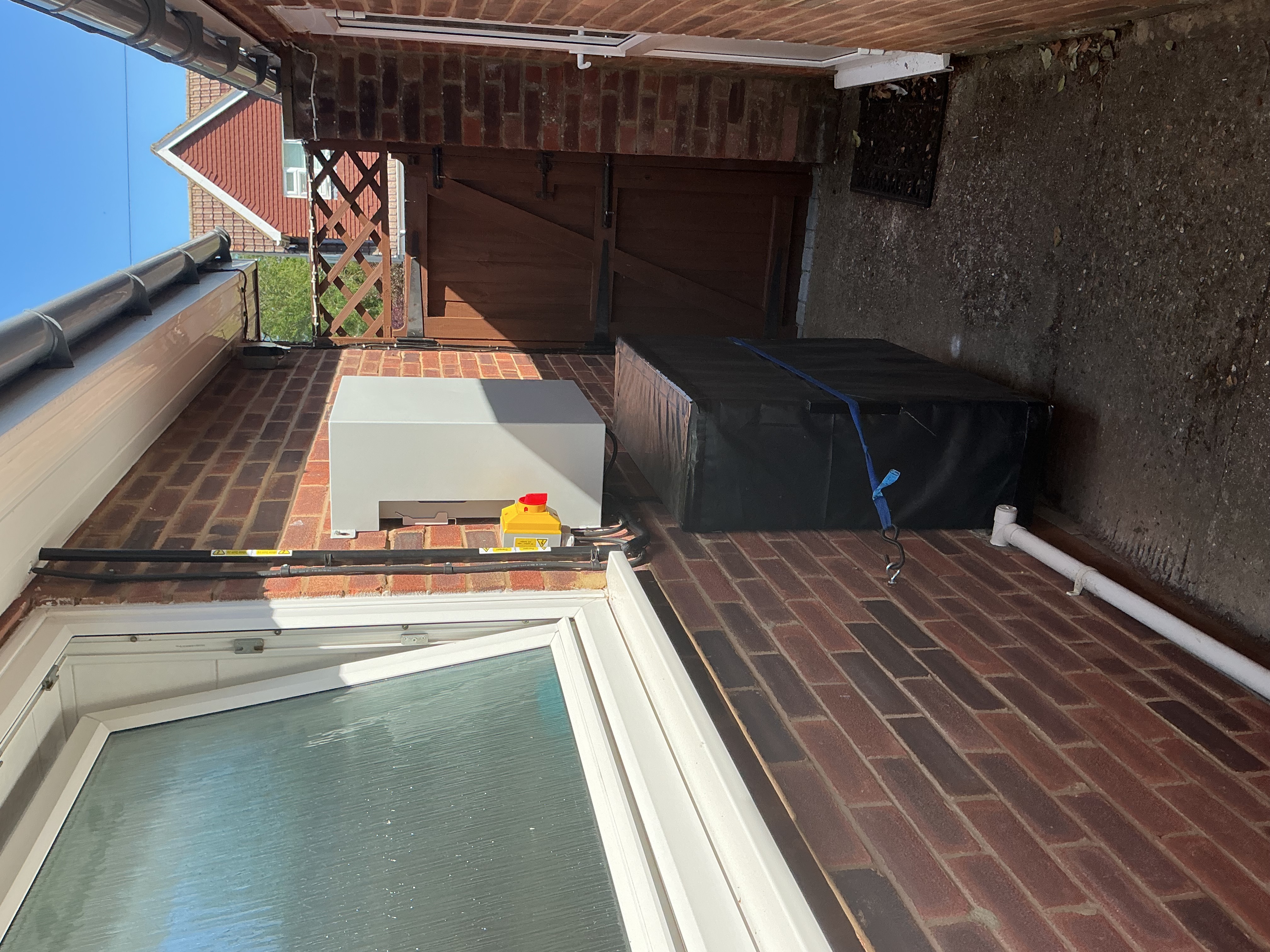

I removed my cover yesterday (the blanket!) and as mine sits in a garage, it does not fluctuate too much these days.
You can see the big spike last night for a charge (with cover off) and a smaller spike in the morning for a 1hr discharge.
If it drops below 15°C then I will consider chucking on the blanket in a single layer :D

Hottest day since system fitted last September, got to believe the insulated cover is keeping temps in the cells down (as per Dave’s comment above )
I’ve got 2 covers, a metal one with 50mm Celotex around 80% of the interior, and another that fits over that made of 50mm Celotex and waterproofed.
Max cell temp today approx mirrors current external temp of around 30/31C
Can see it will be left on all year at this rate.

If you are referring on the filter list to ambient temp, it peaked at 53C yesterday, or INV 1 temperature ranged between 22C when doing nothing at night as drawing from grid to 48.8C in the afternoon when it was pumping out to the grid from solar.
The inverter has a vented metal cover to stop UV and direct sunlight and it’s also at the side of the house under an overhung so sees minimal direct sunlight.
Max battery temp yesterday was between 29/30C all day. The peak was 31.7 at 0100 when it charged by 800w to full.
Cant see the insulated cover ever needed to come off apart from cleaning and bug/rodent checking.
No amount of fiddling gets the photo sunny side up 🤦‍♂️!
